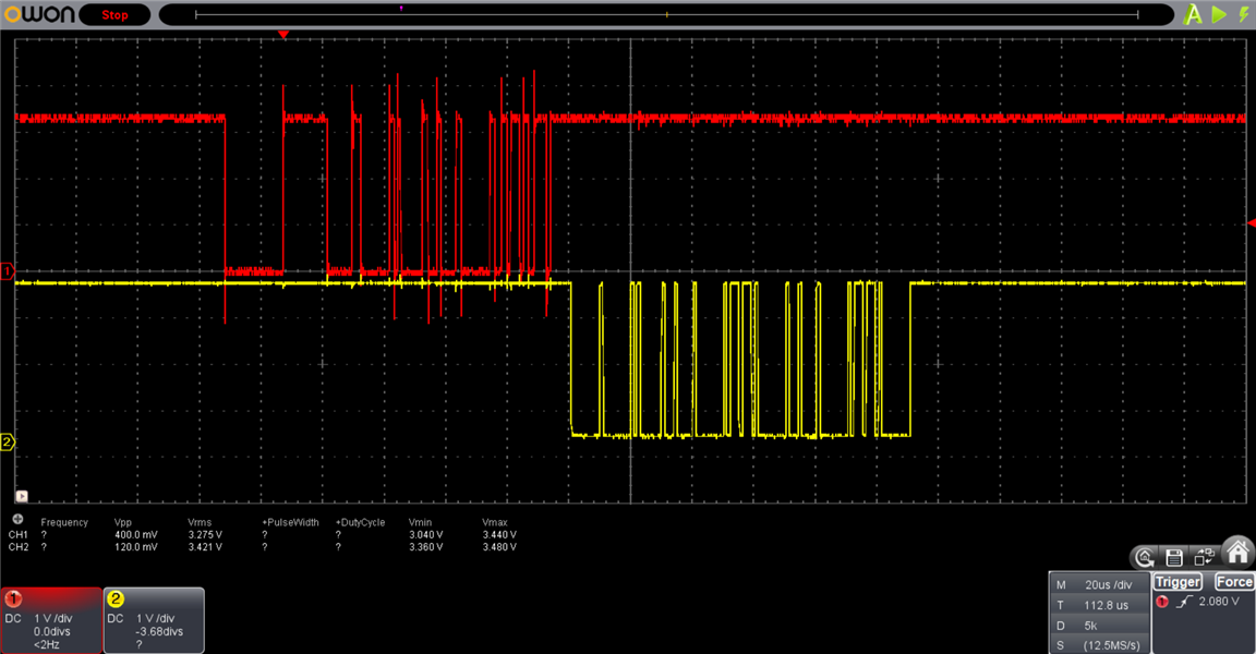

    Can you share the exact command that you are sending to the BQ79606? It would also be helpful if you could share an oscilloscope waveform that shows both the command and the response.
  • Thanks for your quick response.

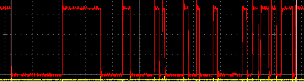

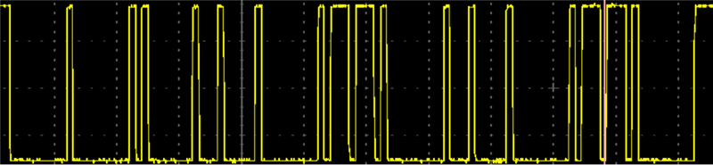

    I will attach a couple of images. Submit a read of the "DEVADD_USR" register.
    The UART is configured with a start bit, a stop bit, 8 data bits, no parity and is FIFO.
    In red the query and in yellow the answer of the BQ79606. In this case the query went to the bridge. To understand a bit how I send the data, I will put part of the code below:
