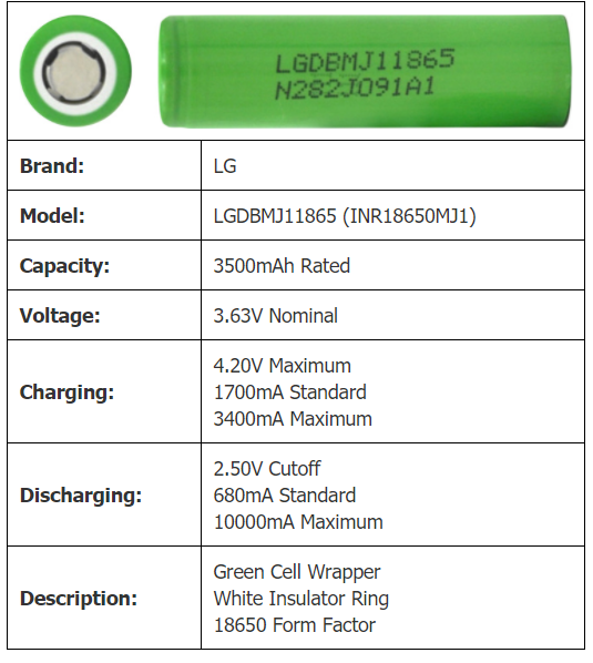

I can not find the Chemistry ID for the battery LGDBMJ11865 (manufacturer is LG) to be used in my products. can you help create and send me the GPCRB file?

I have both the TI bq40z50EVM-561 and TI bqStudio softwre. And I am trying to test a pack of four batteries. But my batteries are not in the list of the Chemistry ID in bqStudio.
Can you send me a updated file with my battery?

Attached is the test record file and basic information of the battery. please let me know if I need to provide more data/information. Thanks, Derong YuanLGDBMJ11865.zip

Hi Derong,
Your logs need to be relax - discharge relax. Your files only show discharge. Please gather the correct data and try uploading again.
