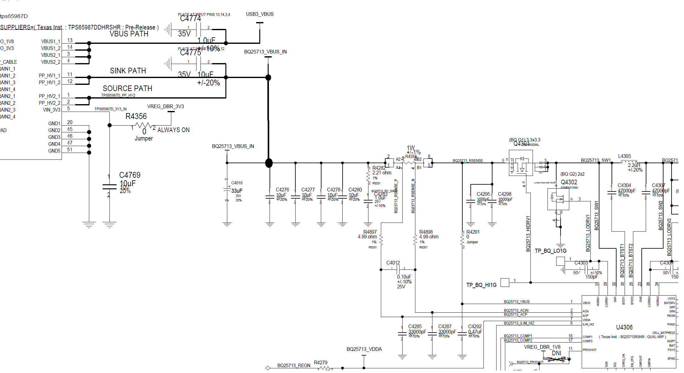

BQ25713: BQ25713 En_OtG bit autoclearing whenever OtG operation is attempted.
Part Number: BQ25713
Other Parts Discussed in Thread: TPS65987D, , BQSTUDIO, TPS65987
I'm having an issue in which the En_OtG (bit #4 of Reg. 0x35) clears upon the instant that I make the OtG/VAP pin (#5) high, and as long as such pin is high, I can't set such bit high again and thus can't activate OtG. Of course, I also have the OtG_VAP_Mode (bit #5 of Reg. 0x34) high and appropriately set the OtG Voltage Register to 5.009V and the OtG Current register to 500mA. I normally use the Low OtG voltage range (bit #2 of Reg. 0x34 High)
Such issue is driving me nuts.
Could you please enumerate all the conditions on which such En_OtG bit will be cleared when OtG operation is attempted?
I know of some possibilities:
1) OtG_OVP & OtG_UVP (bits [1:0] of Reg. 0x20). I know definitively that there's no OVP as the adapter side doesn't rise at all, but I don't know about UVP. At what point upon enabling OtG is a UV condition declared? Does it start switching for a few milliseconds and if it hasn't risen to a given point it quits and disables En_OtG? I can't see any switching attempt nor battery current draw burst when I set the OtG pin high.
2) I know that the battery voltage cannot exceed the the Charge Voltage Register by more than 2% so that there be no Battery OVP condition which would inhibit OtG operation. I set the Charge Voltage Register to 8.856V yet I have the battery voltage at 8.2V so there's no risk of OVP tripping whatsoever.
3) I have ILim_HiZ being driven to 1.2V (for initial 500mA limiting) via a 175.1KΩ(Top)/100KΩ(Bot) divider powered from the TPS65987D's LDO_3V3 output. I confirmed I indeed have 1.2V.
Again, please kindly provide me with all the conditions that may cause the En_OtG bit to autoclear so I may troubleshoot accordingly.

  • Hi Georg,
       The output of OTG mode is on VBUS. Do you have an adapter present while you are trying to enable OTG?
  •  No adapter, what's plugged-in is a little jig board that plugs into our product's Type-C receptacle which presents an Rd (5.1KΩ) into one of the CC lines which then causes the TPS65987D to drive High its GPIO1 which connects to the BQ25713 OtG/VAP line.
    What's really important for me to understand at this moment is what set of conditions cause the En_Otg bit to autoclear..
    This is how the two chips interconnect at a VBus level:
  • Hi Georg,
       The below conditions need to be satisfied first:
    • Valid battery voltage is set REG0x15(), the battery voltage should not trip the BATOVP threshold, otherwise, the converter will stop switching. •
    • OTG output voltage is set in REG0x3B() and REG0x32[2], if REG0x32[2] = 0, the VOTG digital DAC is offset by 1.28V to achieve higher range from 4.28V~20.8V, if REG0x32[2] = 1, the VOTG digital DAC is from 3V to 19.52V. •
    • OTG output current is set in REG0x3C().
    • The actual EN_OTG pin is high
    You want to verify that there are no fault conditions as well. An OTG UVP can occur if the load on VBUS is higher than the OTG Limit setting, causing VBUS to drop below the OTG_UVP setting, which is set as 85% of your OTG output voltage setting. Reading the status of the Charge Status register will indicate if any fault conditions is interrupting OTG.
    Also verify that your watchdog timer is not resetting any values back to its POR value, as default is OTG disabled.

    One thing that I seem to see is that Register 20's bit #0 (Fault_OtG UVP) seems to get set and that disables OtG.  I can't see any attempts on Q4 to switch.  Q4 works fine in normal forward mode as I can generate a 9V VSys from a 5V VBus which require Q4 and Q4 to switch as to boost.from 5V to 9V.  During OtG attempted operation, I confirmed that Q4 has proper battery voltage on its Drain.
    Is there a description of how long the BQ25713 attempts to run before it declares an OtG UVP condition?  Also, are there any conditions (other than those discussed previously) that would inhibit the BQ25713 to switch its FETs in OtG mode?
    Thanks so much,
    Georg A. Mussenden
  • Hi Georg,
        What is your OTG current limit, and is VBUS loaded or unloaded while enabling OTG, and observing this OTG_UVP?
  • Is in the example below set to 1.8A and there's no load, the BQ25713 is connected to the TPS65987D as shown on the picture I posted above on October 21st.  The TPS65987D appropriately drives High GPIO0 which drives the OtG whenever it detects an Rd pulldown on one of its CC lines.
    It must be noted that the BQ25713 doesn't do an attempt to drive in switching manner the gate of Q4 (remember this is a reverse buck from 8~9V to 5V).  So it's not that it's trying to switch and then faces a heavy load/short and then collapse.  It simply refuses to switch and then declares a UV as obviously nothing comes out.

  • Hi Georg,
        What is the contract that the sink has negotiated? How are you sequencing the PD controller negotiating the contract and setting the OTG enable? I have not seen this issue before as PD+buck boost charger designs haven't run into this issue as far as I know.
  • Hi Kedar!
    The '65987D correctly drives the '25713 OtG line high (3.3V) when an Rd is present at its Type-C receptacle and low when it isn't.
    When facing a basic Type-C sink we present a [Legacy] 80µA Source Ip and we set the OtG current limit to something slightly greater than 1A. When facing PD sinks we offer a single 5V, 1A source PDO, again setting the OtG current limit to something slightly greater than 1A.
    Again, the primary question is why when the '25713's OtG line is High, whenever I try to set Reg. 0x35 bit 4 (En_OtG) High, it's immediately autocleared and a Reg. 0x20 bit 0 (OtG UVP) reported.
    As I asked, please examine the register contents I sent you to see if there's anything wrong and also please send me register contents that work for you.
    Thanks so much,
    Georg A. Mussenden

  • Hi Kedar!
    The issue I found out was that IDChg_VTh (Bits [7..2] of Reg 0x39 must not be zero (as it was in our SW), but rather the Max. continuous current that's expected to be drawn from the battery..
    Admittedly I didn't ever play with IDChg_VTh which the BQ25713 defaults to 0x20 (16.384A) but was somehow inadvertently changed to all zeroes in our SW.  I actually thought of such IDChg_VTh as something just ProcHot/VAP (which we don't use) related and failed to realize its extreme importance, and since it defaulted to a very high value it didn't bother me at the early stages when I was entirely manually playing with the BQ25713 as I never [intentionally] touched it and changed it.
    IDChg_VTh works in unison with the En_BatOC and BatOC_VTh bits (#1 and #0 of Reg. 0x32) in which if En_BatOC is enabled (which it is in our code), obedience to IDChg_VTh (qualified by BatOC_VTh) is enforced.
    Also , IBat_Sel (bit 6. of also Reg. 0x32) ought to be 0 during OtG operation or when nothing is inserted in the Type-C receptacle as obviously no charging can happen. It's more tricky when an EPS (Source) is plugged-in. In general if a Source that satisfies all the system power needs, the direction of current flow ought to be always Charge Current (i.e. IBat_Sel ought to be 1), but when lthe EPS can't fulfill the system needs, the overall system could be running in deficit mode so it could at (or all) time(s) be discharging the battery.
    In summary this's what I indicate how such registers ought be set:
    i2c wr8 1 0x6B 0x32 0x3A
    i2c wr8 1 0x6B 0x33 0x00
    i2c wr8 1 0x6B 0x38 0x03
    i2c wr8 1 0x6B 0x39 0x30  (e.g. for 6.144A).
    I strongly recommend that section 9.3.4 USB On-The-Go (OTG) of the spec. be updated to include appropriately setting IDChg_VTh.
