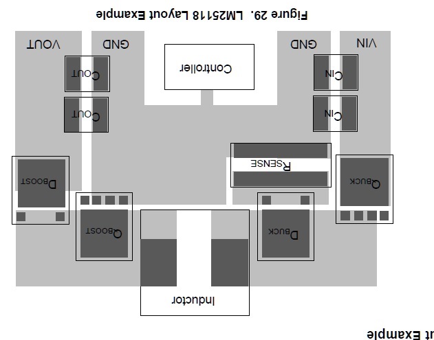

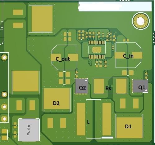

We have a layout based largely on the application note in the datasheet (snvs726f.pdf). The board is 4 layers, 2 Oz copper and is of sound construction.

    Please try to add high frequency ceramic capacitors very short from the high-side FETs to GND. Be aware that the capacitor has a frequency range of up to 100MHz.
    Check if you can reduce the length of connecting cables on VIN and VOUT. Often the connecting cables are antennas.

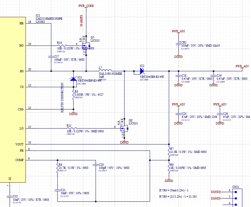

    The datasheet makes mention of a snubber requirement. As you mentioned, we figured that maybe our choice of diode had something to do with it and / or ringing in the edges of the switching at the inductor.
    To try and correct the problem, we placed a 680pF + 2.2R snubber from each side of the inductor to DGND.

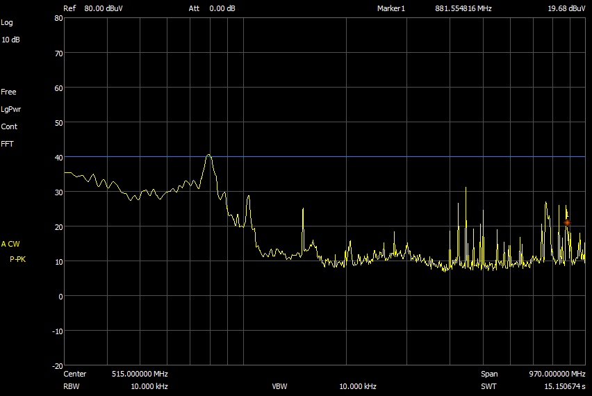

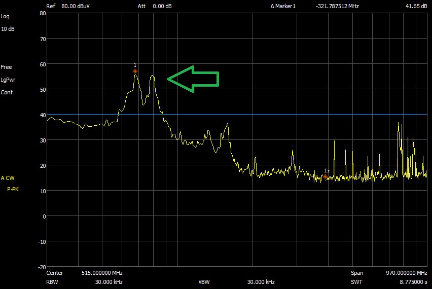

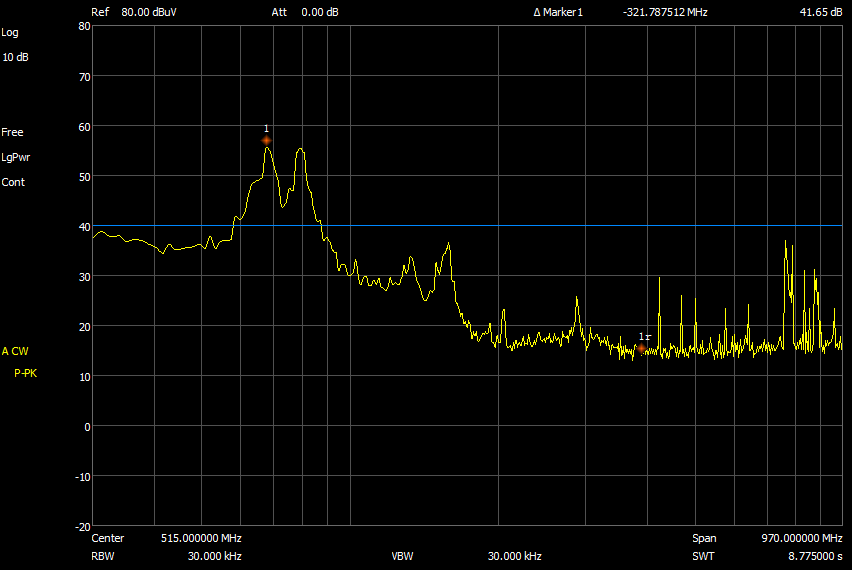

    For comparison:
    Before Snubbers:
    After Snubbers:
    Given the clear reduction in emissions using this approach I'll mark this as solved. Maybe TI could consider revising the snubber section in the datasheet and / or on the EVM to make it a bit clearer to designers of the challenges with using this part.

    The key is the snubber and also we changed the slew rate control resistors on the gates of the MOSFETS.
    In general the gate resistors had the biggest effect in eliminating the ~80 MHZ noise.

    At the lab, during an official conducted emissions test to CISRP-11 we had a peak of +10 dBm over the 40 dBm limit at about 80 MHz at 3 meters.
    We did a study of the gates of the FETs using a scope with appropriate spring clip probe right at the FET. We noticed that in the edge of the gate switching there was some ringing, the frequency of the ringing was about 80 MHz. We increase our gate resistor to about 22 R, which reduced the ringing, and we considered that this change did not have a thermal impact on our design.
    Changing the gate resistor reduced the peaks at about 80 MHz by about 10-15 dBuV in our TEM cell, this was a massive change.
    We still had broadband noise from about 30 MHz up to about 500 MHz and by adding the snubbers (680 pF + 2.2R) between each side of the inductor and ground. This reduced the overall broadband noise by about 5 dBuV in our TEM cell.
