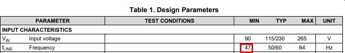

I have a question regarding 10.2.1.1 Design Requirements of the dahasheet.
fLINE is defined as below;
However, it is calculated as below though the minimum frequency is 47Hz.
Why is 57Hz used on this calculation?

I believe that is a typo in the data sheet.
It seems that the systems engineer that had written the UCC28910/1 data sheet should have proofed it better.
Thanks for letting us know about the errors. I will let him know about the errors in his calculations.
