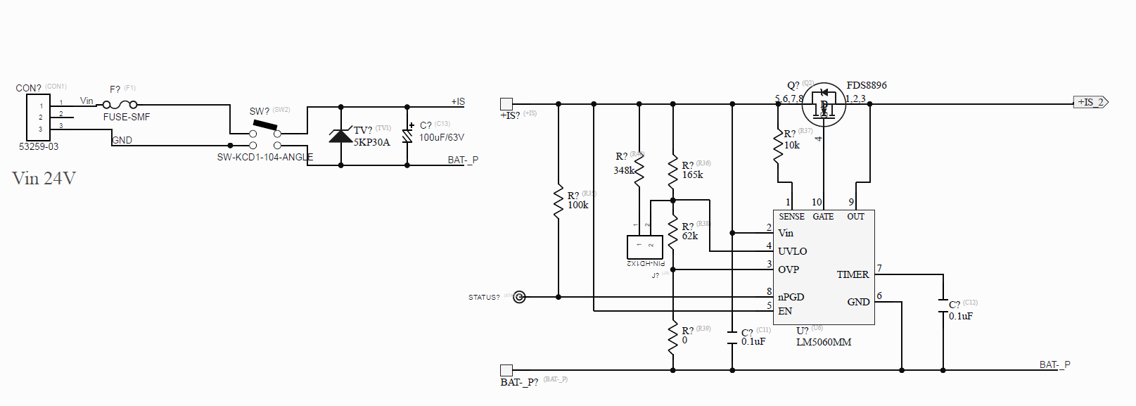

hi
lm5060 applied circuit, ic burned out
Order of operation
1. Input voltage 24v
2. Switch on -> off
3. ic burnout (with smoke)
Need to add circuit protection?
waton_lm5060.pdf
  • Hi Kim,
    Is the failure happened during turn-OFF ?
    What is the capacitance at the output of LM5060 ?
    Best Regards, Rakesh
  • Hi  Rakesh
     ->   It was happened turn-on(smoke)
           I think it breaks when off and smokes when i turn it on again
    ->  There is no capacitor at the lm5060 output stage,
          it is directly connected to the DCDC converter.
          DCDC Converter specification
          WRA2412S-3WR2 (MORNSUN)
          WRB2405S-3WR2 (MORNSUN)
         When the input voltage is 9V with the same circuit, the problem did not appear.
  • Hi Kim,
    Thanks for the details
    Can you share test waveforms during turn on and turn off events. Include Vin, Vout, Gate, fet current in the test waveforms.
    Best regards, Rakesh
