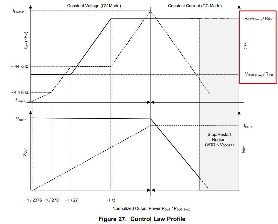

Part Number: UCC28910
VCCR is defined as CC regulation constant and it decides ID_PK as equation(28) with RIPK.
However, VCCR is nothing in figure 27(control law profile).
What is the role of VCCR?

Hi Tadahiko-san,
Vcste(max) and VCCR are related. Please take a look at equation 23 in the UCC28910 datasheet for the relationship. Both KCC and VCCR are internal constants that help determine when UCC28910 will enter constant current mode. While VCCR is not directly listed in figure 27, VCCR is related to Vcste(max).

Hi Ben-san,
Thank you for your help.
According to figure 27, ID_PK is VCTE(max)/RIPK when CC mode.
When can we see ID_PK of VCCR/RIPK?

Hi Tadahiko-san,
The relationship between VCCR and Vcste(max) is VCCR = Vcste(max) * Kcc. You can translate the figure 27 graph to be VCCR/RIPK by multiplying by Kcc.Kcc is a constant that is specified in the electrical table (0.413 nominal).
