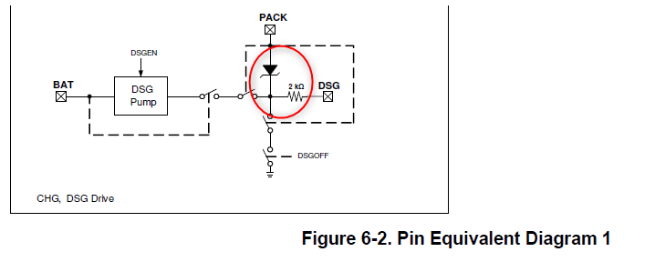

Hi team,
My customer has some question about the BQ40z80.

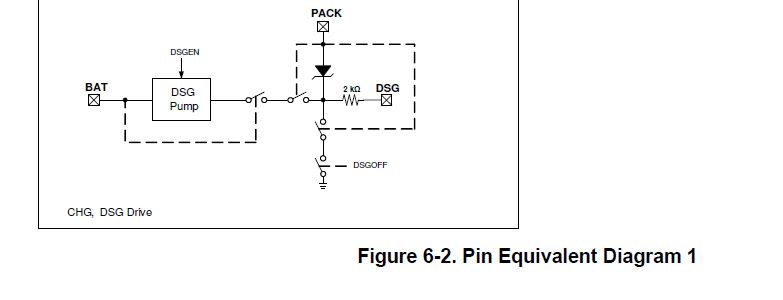

1. They want to know why there is a diode and a 2kohm between the DSG and the PACK pin

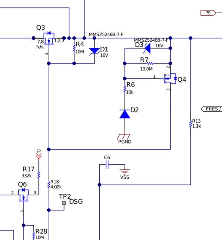

2. In the schematic, they want to check the reason why we need D1 and R6. How this circuit works?

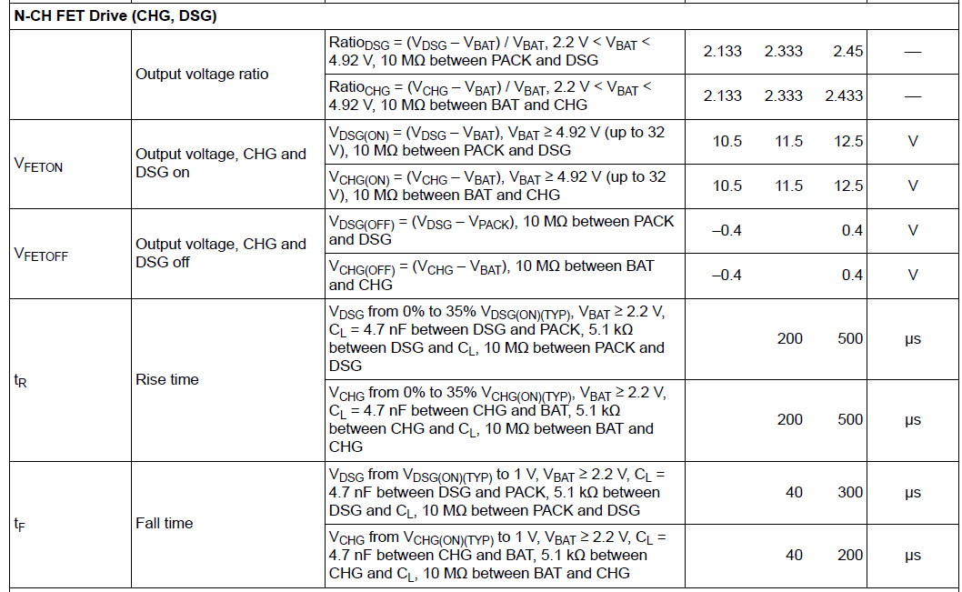

3. How much current could DSG pin provide?
Thanks a lot!
