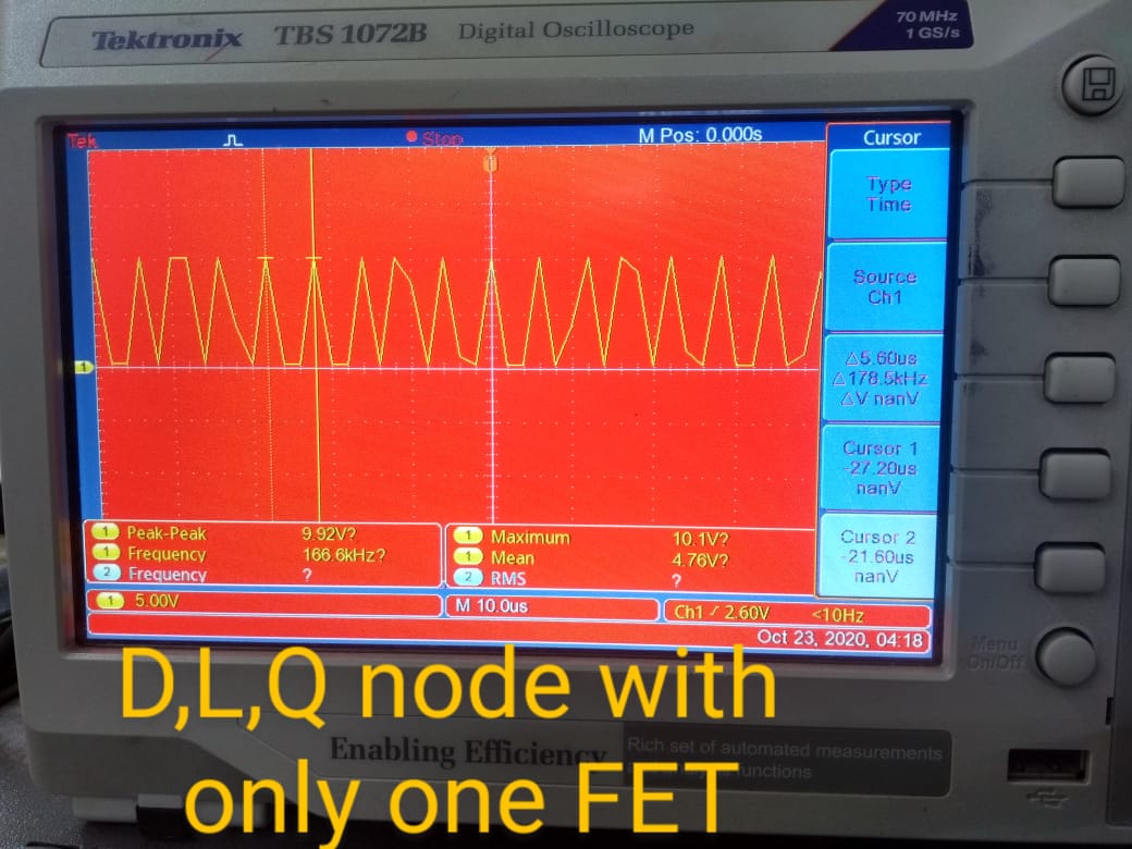

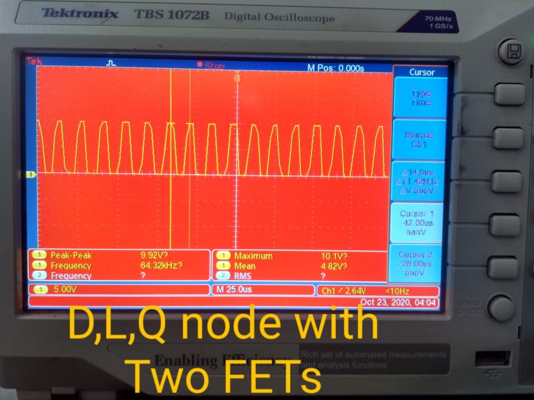

    If you can scope shot the Switching node (node of FET, diode, and inductor) that would be great for confirming stable operation.
    Actually I think the dual-FETs are contributing to this issue. The FETs connected in parallel will halve the RDSON but it will double the QG gate charge.
    Double the gate charge will negatively affect FET rise and fall times, increase switching losses, and negatively contribute to thermals.
    This would not appear in the 12V as it is 100% duty cycle and not switching.
    Please check the PGATE rise and fall time and also only with a single MOSFET.

    Dear Orlando,
    PFA the scope shot of the switching nodes as specified by you. I can say there is only a slight reduction in the heating when only one MOSFET is used, nothing has changed drastically.
    The FETS I have used is FDS4435BZ.
    Also, now I have changed the feedback resistors to 60.7k exactly instead of 62k and also, the inductor used is a 22uH. But practically the heating difference is not much, even for a load of 50mA there is significant heating upto 34C, the ambient temperature here is around 20 to 22C

    What is the output current of these scope shots?
    The switch node rise and fall time look very long, like several microseconds?
    SW node should be a square wave, please check if the PGATE output is square.
    I do not think 34C is too hot but it depends on the load.
    You can try reducing the switching frequency by increasing the inductor and there should be improvement.
    Your powerstage layout could be improved, switch node routing is not optimal and I think this is contributing to slow slew rate.

  • Output current is around 50 to 70mA for the scope shots
    Yes the switch node rise and fall time is around 14us

  • Krishna,
    14us is very long, increased SW node rise and fall times will affect the switching losses in the PFET and FET will be hotter. Better SW layout should help with faster rise time.
    Your temperatures at high current are expected, at low current it is a bit hot. I'm not sure why the device is not in discontinuous mode like figure 16 of LM3489 datasheet), are you able to scope the inductor current with a loop (on VOUT side)?
