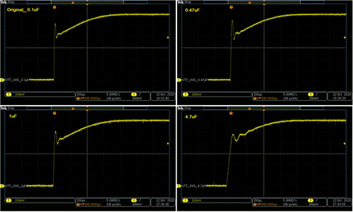

Dears,
I found related this question on E2E, the suggest place output cap from E2E answer was below 1uF.
But I saw the forum before seems like 4.7uF was better then 1uF?
https://e2e.ti.com/support/power-management/f/196/t/587546?tisearch=e2e-sitesearch&keymatch=TPS51200
Can you comment about this question?
Original design was 0.1uF.
BR
