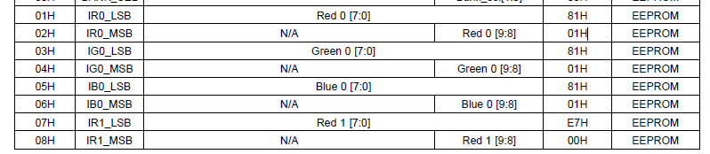

On the X-axis in Figure 7, the current setting looks like 9 bits up to 1023, while the LED current setting registers from 01h to 12h have a 10-bit (8-bit and 2-bit) allocation.
Does the D1 bit of the even address (02h, etc.), which is the MSB, affect the LED current?

  • Hi Shoji,
    FOR Q1:
    please refer to the following pic. it shows that current setting is up to 10 bits. D1 of 02H is the MSB of the current setting.

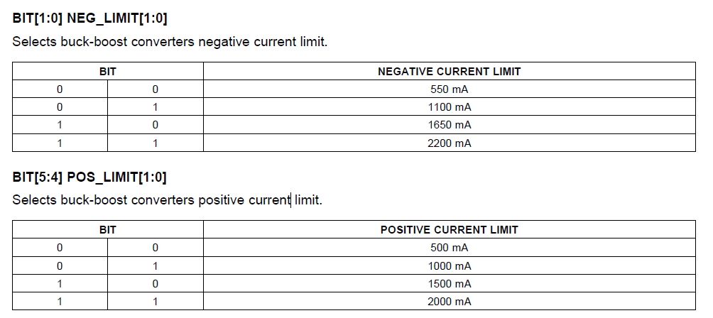

    And when driving with the maximum current of each color, is it OK to set the current limit of the buck-boost converter to 500mA on the positive side and 550mA on the negative side?

  • Hi Nakayama,
    FOR Q1:
    Yes, you are right~
    FOR Q2:
    if you setting maximum current of R/G/B to 600/500/400mA,  the current limit of the buck-boost converter should at least set to 1100mA/1000mA.
