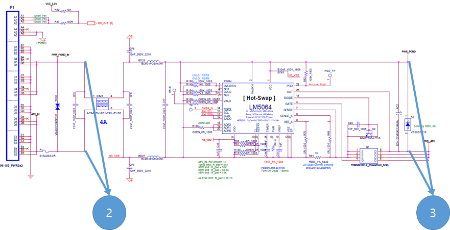

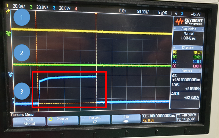

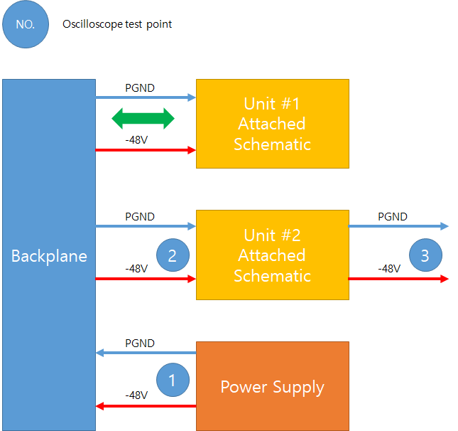

The system is configured as shown in the attached picture. If Unit #1 is inserted while Unit #2 is inserted, it seems that Unit #2's hot-swap (LM5064) is in progress. -Oscilloscope point 3 (actually reset.)
When the power supply and the input power of Unit #2 are checked by scope, there seems to be no problem at all. I have no idea for any reason.
The above phenomenon is also the same in the opposite case.
(For example, when Unit #1 is inserted while Unit #2 is inserted)

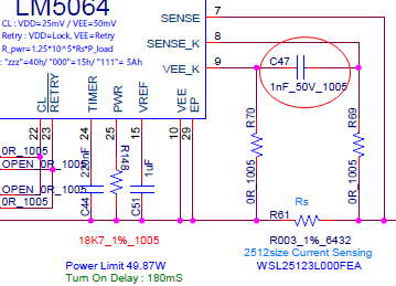

  • As shown in the attached schematic below, Use and check a filter cap on a shunt resistor. I tried changing the 1nf, 100pf, and 10pf, but the result was the same.

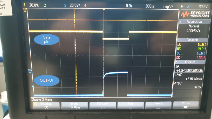

    With an oscilloscope, I measured the gate pin and the external FET output stage. It was confirmed that the LM5064 blocks the output of the gate pin.
    I wanted to measure the timer pin, but when I connect the probe to the timer pin, the power turns off. How do I measure it?
    To further check, I read BLACK_BOX_READ (E0h). However, no special faults appeared.
  • What are the values of R69 and R70 ? If it is 0 Ohms, please retest with 10 Ohm value and 100nF for C47
  • R69 and R70 value is 0 Ohms. As advised, I retested with 10 Ohm value and 100nF for C47.
