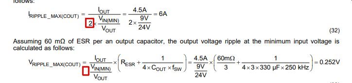

Dividing 2 disappears on equation (33) as following red rectangles.
Is this typo?
Kuramochi
Is this typo?
Kuramochi
Hi Kuram0chi-san,
The "2" is combined in the "4" within the parenthesis. (See your other post for details)
For the ESR ripple, it needs to multiply by 2 to get the peak to peak value so it cancels out.
Yinsong
Hi Yinsong-san,
Thank you for your help.

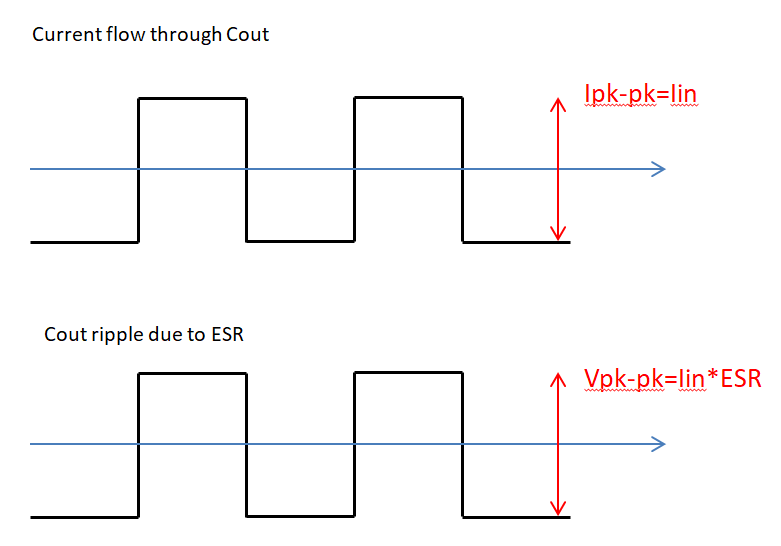

What is the peak to peak value? Is this the value of Vripple?
If you show me a waveform, it will help my understanding.
Kuramochi
