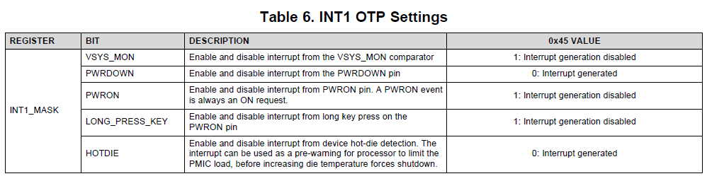

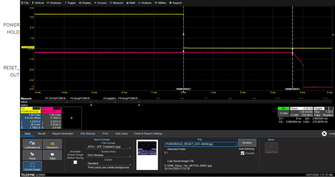

GPIO_5 is set at POWERHOLD and DEV_ON is set at 0h.
Following picture shows that RESET_OUT is still high though POWERHOLD become low but RESET_OUT become low when power is off.
Why this IC don't be ACT2OFF mode when POWERHOLD is set at low?
I would appreciate if you share your thoughts how POWERHOLD can work.
