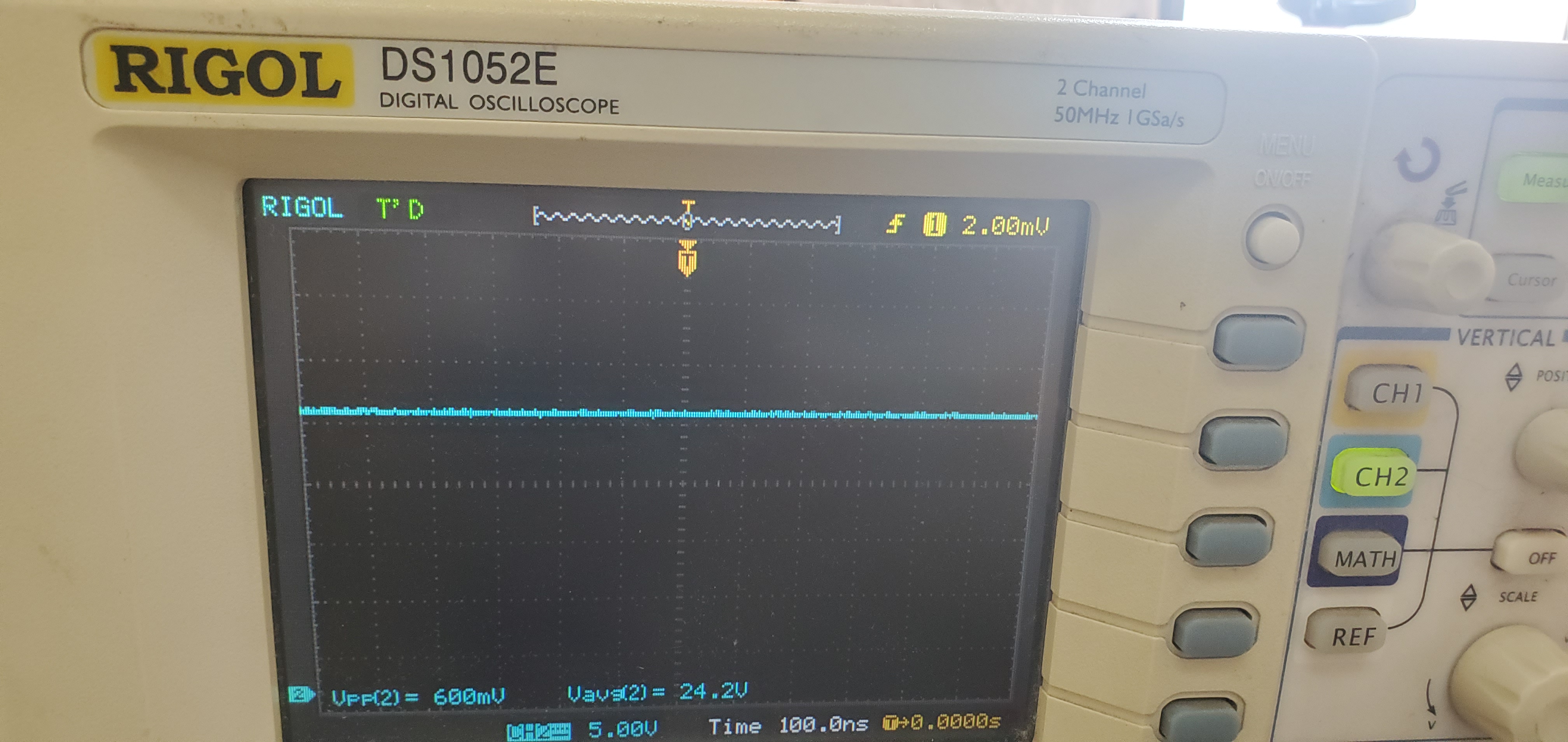

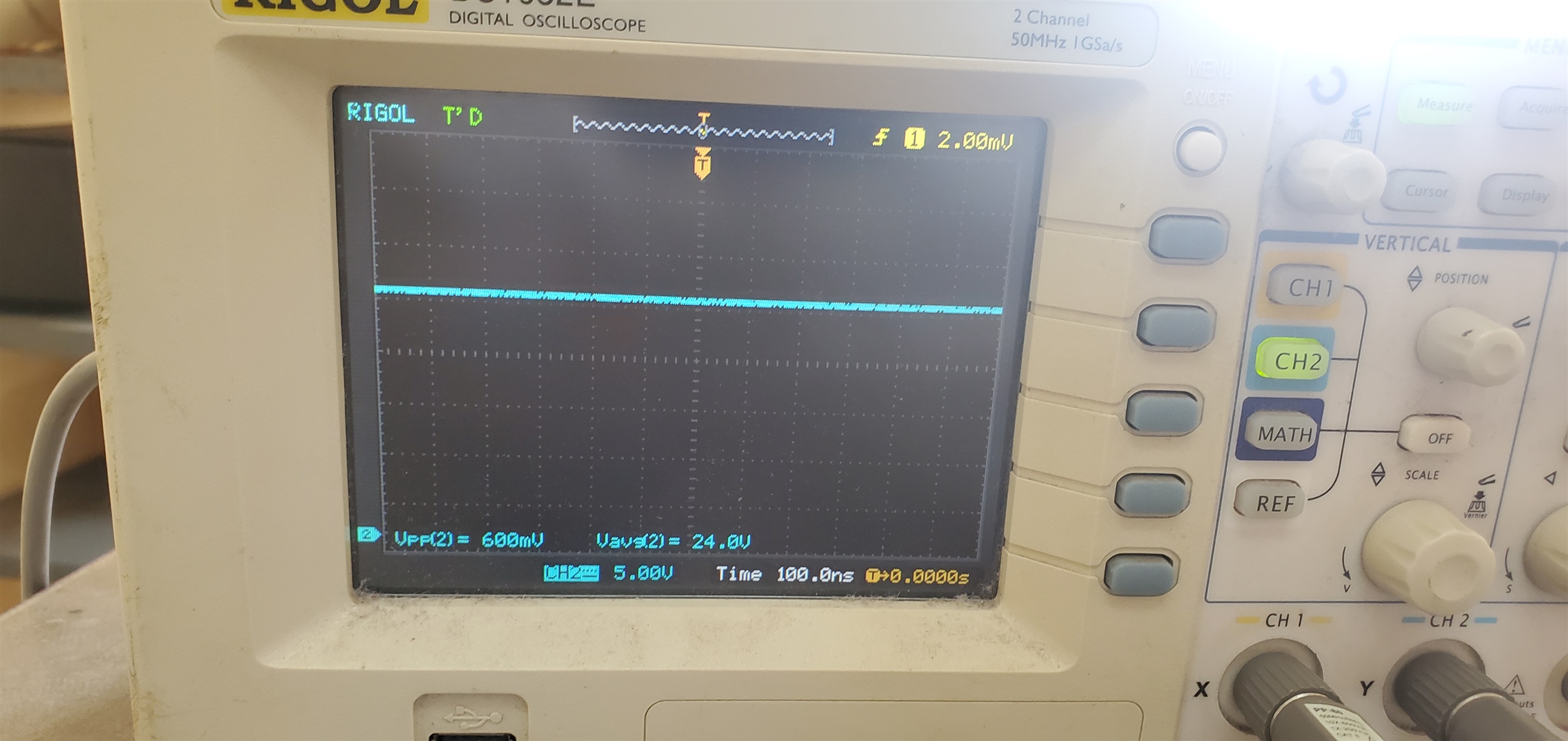

    I am adding oscilloscope waves for 2 boards, one works as per design, PCB design is same components are from same reel.
    The above photos shows the output of the power buck converter that has DRV connected as load (no motor is connected) , so the standby voltage , the 1st photos is only the output, the 2nd photo is shows the output will multimeter connected to TP3 and TP2. the output jumps to 27 and settles to 26.2V and clicking sound starts, it corresponds to the oscillations of the wave.
     Below photos show the output at same testing setup of the board the board that works as designed, again same PCB design, components from the same reels, but there is no clicking sounds.

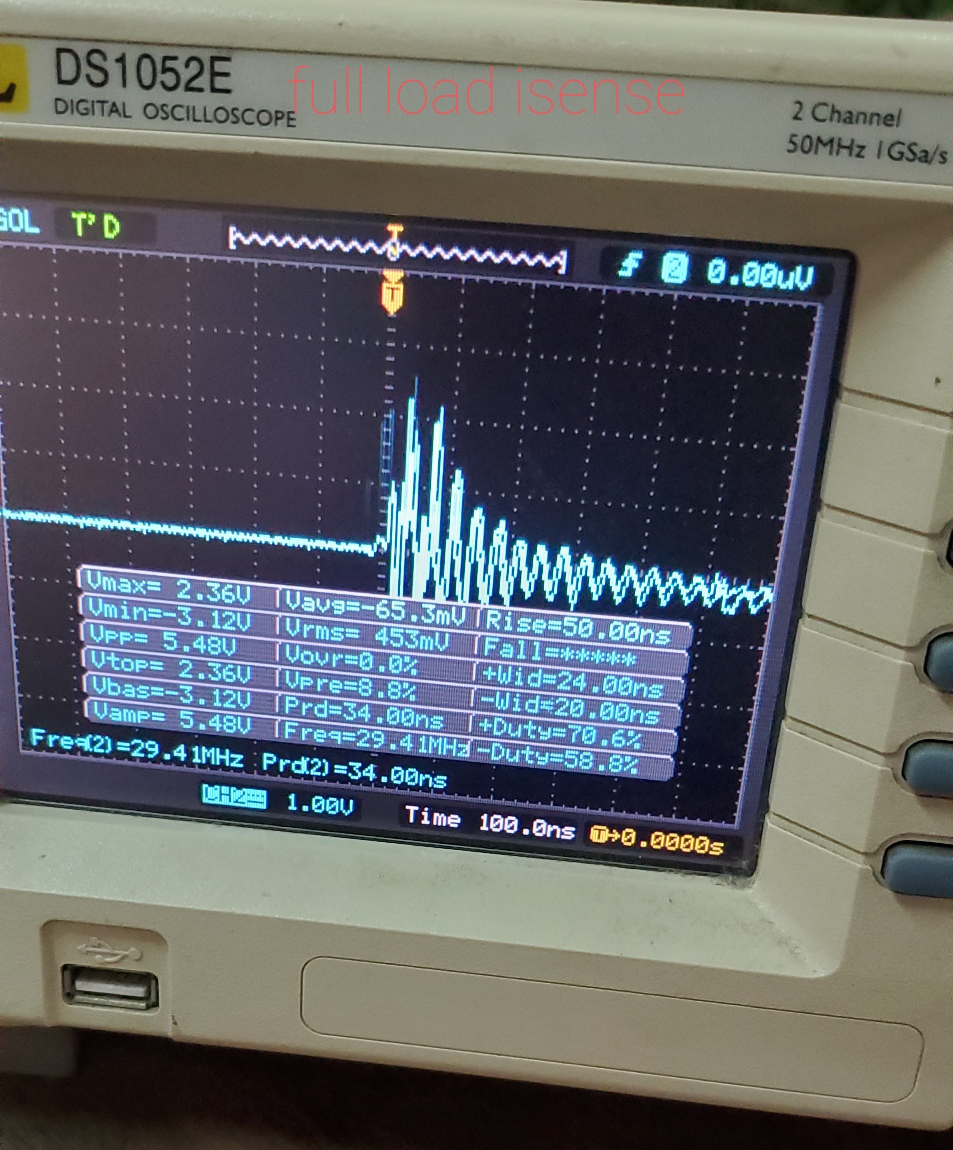

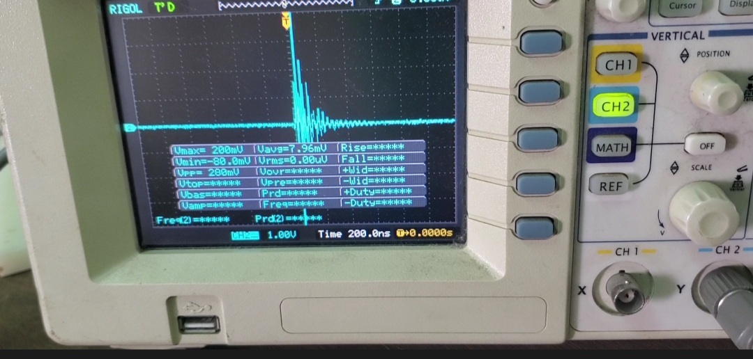

    I am attaching waveform of a working board and none working board, there is alot of noise on the Isense signal when the MOSFET gate is triggered hence the UCC28180 switching off and turns on .
    above are  full load isense and Gate drive signal at pin1 of UCC28180

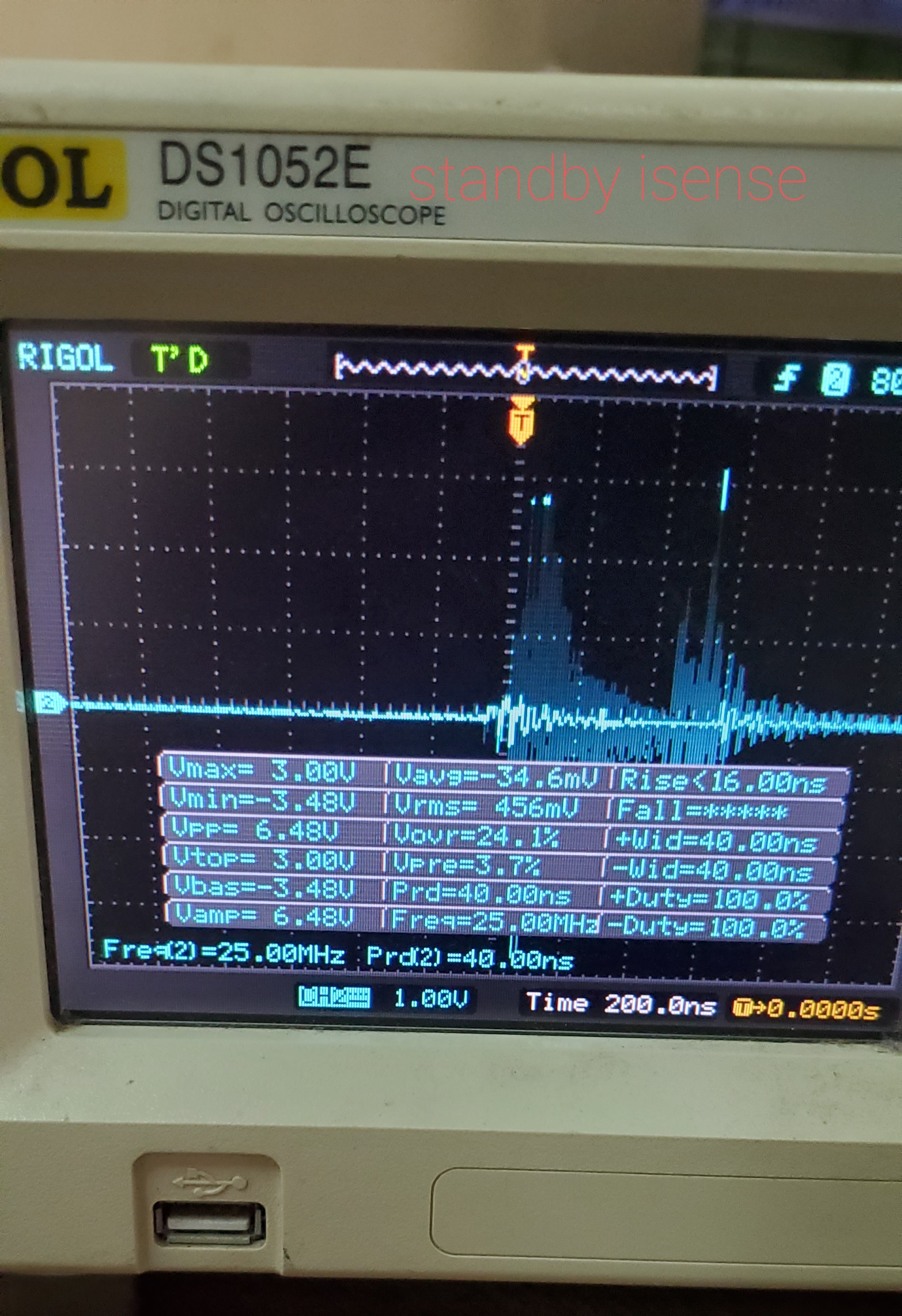

    below photos are at standby ,19watt. all photos are of working board.

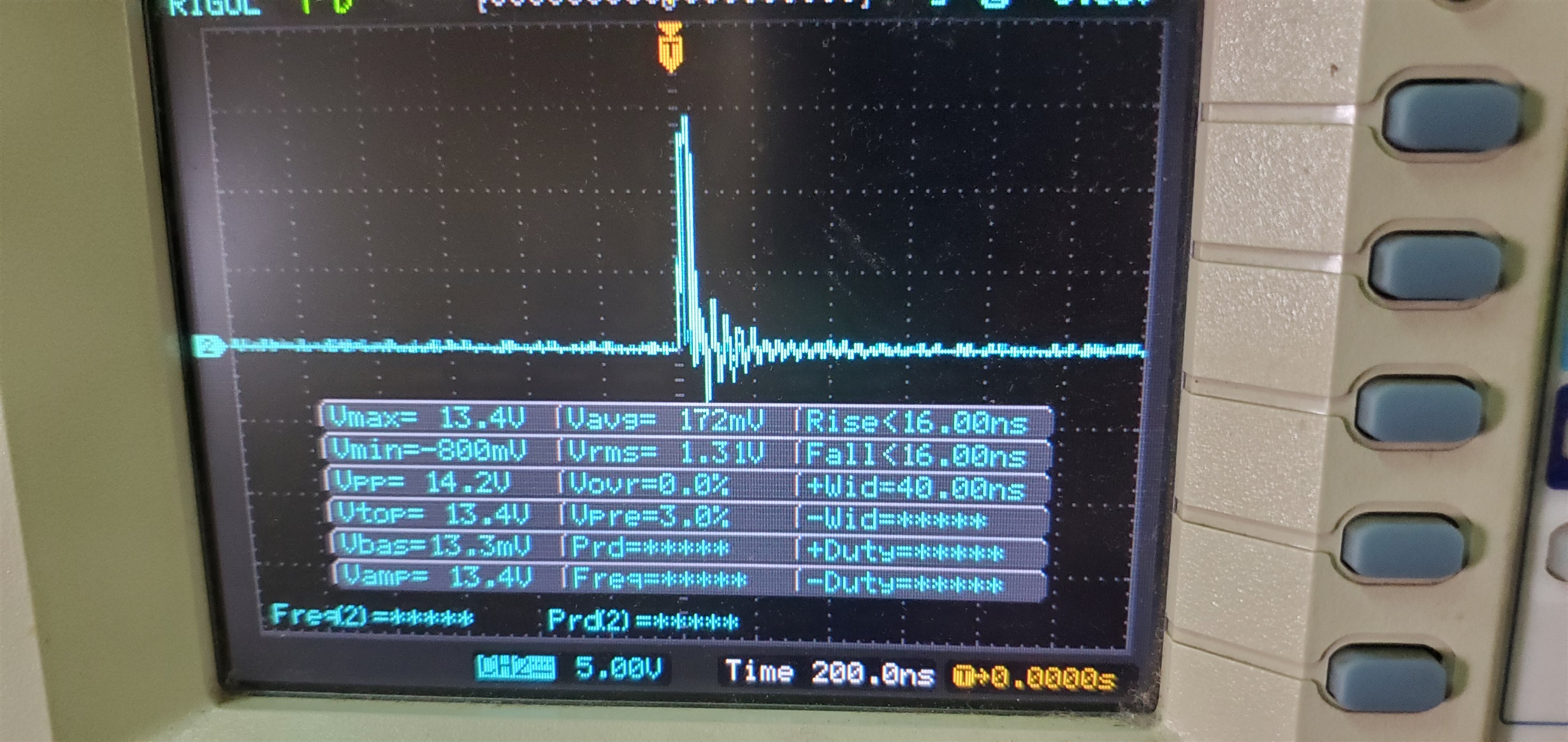

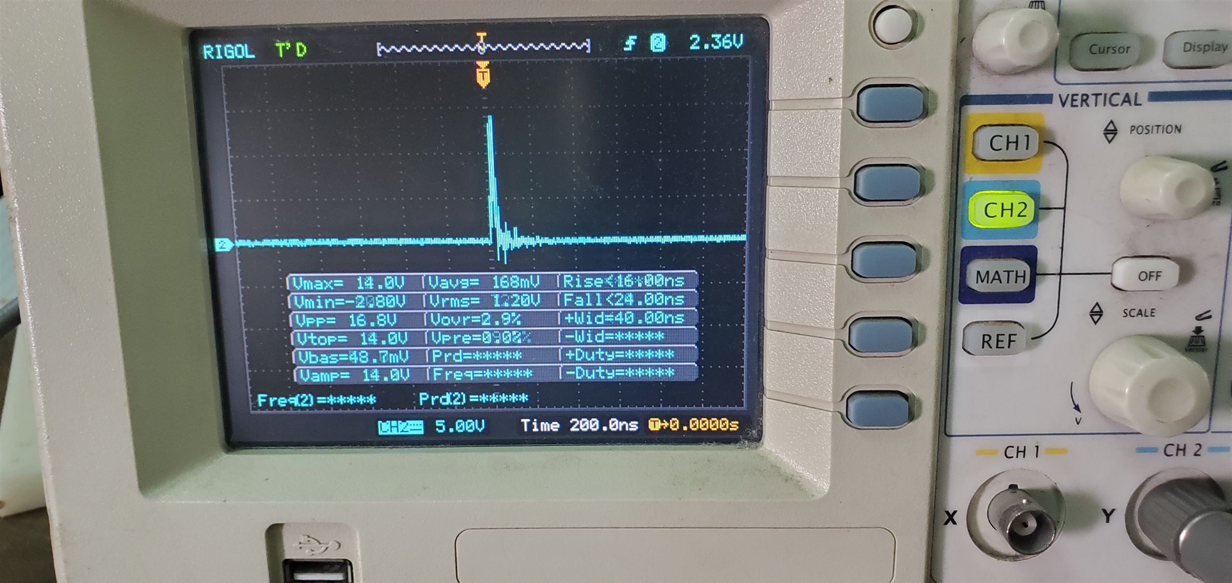

  • board which have trouble holding required current 1st is since at standby , 2nd is trigger at the pin of ucc28180, there is large spike which is positive . Also such boards have voltage on TP3 as well, when the power supply is loaded.

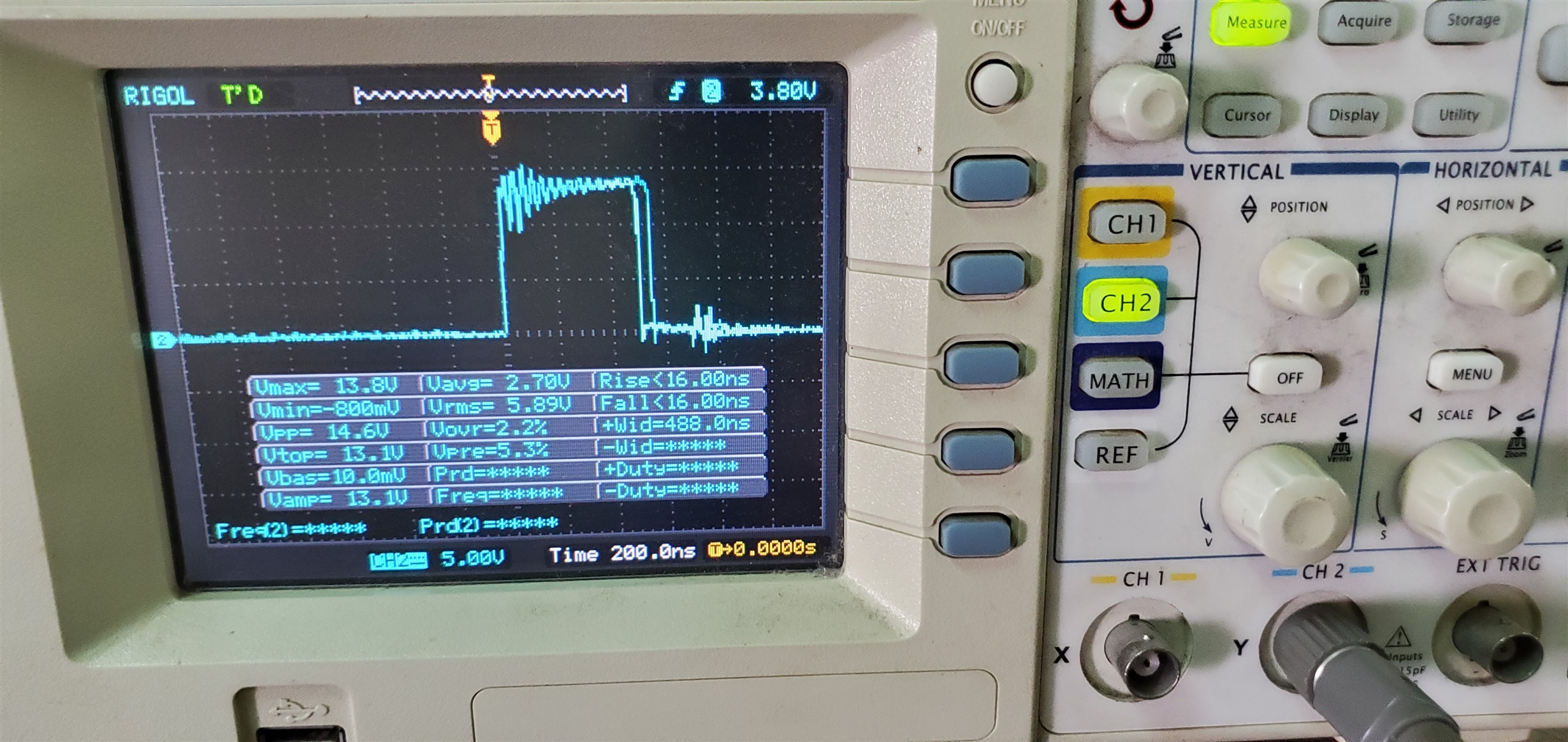

  • one moare suggestion is that can you please increase the turn on resistor to limit the ocilation on the driving? From your waveform, there are big oscillation on Gate driver signal.

    the non working boards seam to get a high isense voltage when the Mosfet is triggered, it is suppose to be in negative and uV to mV, and the spike is 1 to 4 volt when the mosfet triggers but the board that have issue the voltage fluctuates from negative to positive and the spike is upto 6 to 14 volts, I believe this is why the current (PWM) has issue stabilizing as per demand.
    I cut the gate drive track and used a wire to confirm , and the boards seam to work after failing to to go to full for 2 to 3 time, it is repetitive every time the power supply is turned on.

  • Hi David
    your suggestion for resistance increase has solved the noise issue and the boards are working , have connected load and testing the boards for any other variations.
