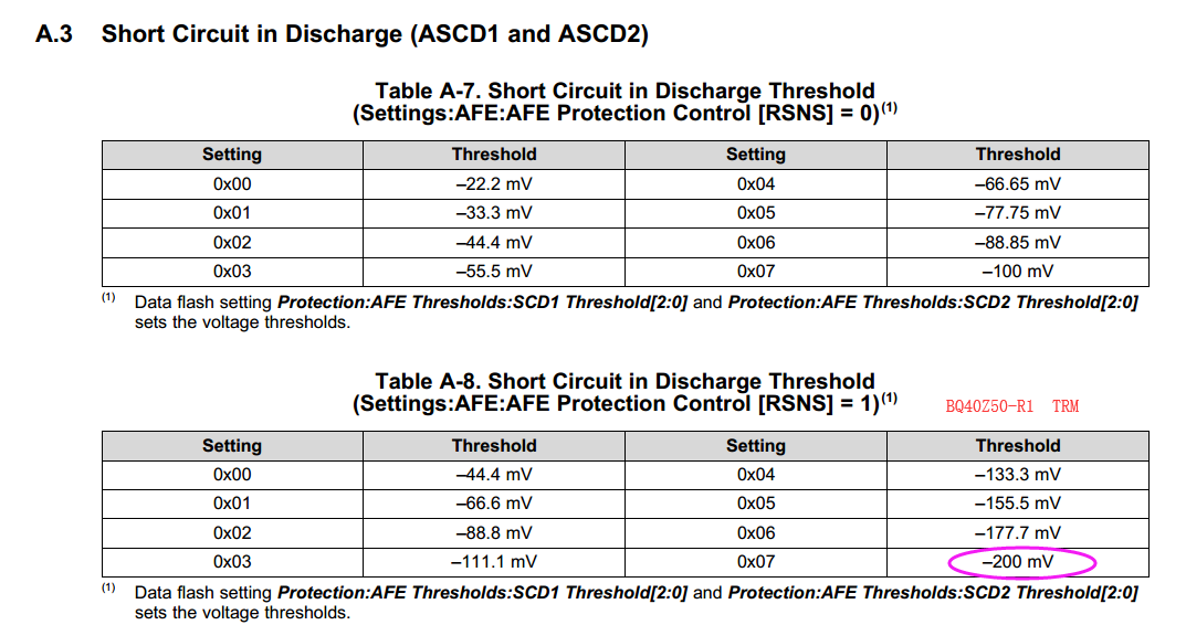

BQ40Z50-R1: BQ40Z50-R1 short issue
Part Number: BQ40Z50-R1
Pls answer the below questions
1. Can BQ40Z50-R1 detect discharge short circuit voltage when it's small than -0.2V and act short circuit protection turn off CHG and DSG MOS FET or DO NOT detect  discharge short circuit voltage and do nothing?
2. IF NOT, when the discharge short circuit voltage is small than -0.2V, how do we design it.

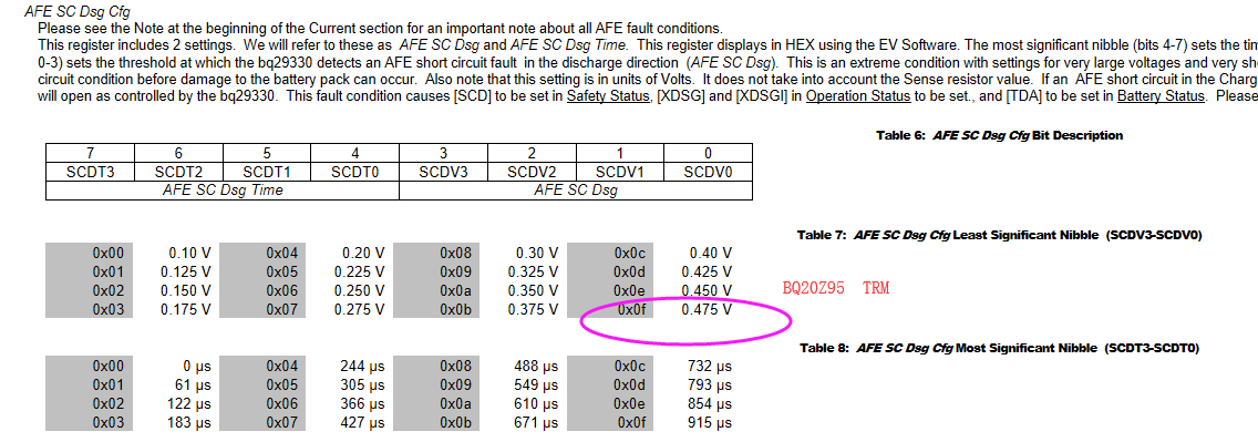

3. In addition, BQ20Z95 short circuit voltage is -0.475V and BQ2095 has ASRP ASRN can do partial voltage when short circuit is bigger than 0.475V.
Why BQ40Z50-R1 short circuit voltage  is designed to be so large?
