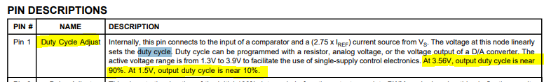

A customer wants to compute for the value of RPWM resistor for DRV103H to create a 65% duty cycle at 24kHz oscillator frequency. The closest values specified in the datasheet are for 60% or 70% at 25kHz. What is the computation for other frequencies and duty cycle?

    There are a few equations we need to use to pick an arbitrary duty cycle thats not in the d/s. The duty cycle depends on Rfreq as well.
    Rfreq calculation from F is below:
    So Rfreq~212kOhm for 24kHz.
    IREF = 1.3V / RFREQ , RFREQ is the resistor you choose for your frequency (212K)
    IREF ~ 6.12uA.
    Vduty is the voltage at the pin1 for duty cycle adjust
    Vduty=2.75*IREF * Rduty
    From below, we can get the linear equation for Vduty vs D%, and relate that to RDUTY  / RREF
    D%=0.392*Vpwm - 0.4944
    and from that,
    D%=0.392*2.75*IREF*Rpwm - 0.4944
    D% will be from 0.1-0.9,  btw. Multiply slope/intercept by 100 t0 get 10%-90%
    From above equation i get Vpwm=2.92V, from there we calculate Rpwm = 2.92/(2.75*IREF)= 173kOhms

  • Thank you for providing me with that information. For the oscillator frequency, I chose a 210k ohm 1% resistor and for the duty cycle adjust, I chose a 174k ohm 1% resistor since they are the closest standard values.
