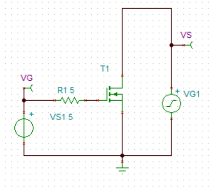

Hi team,
It is nice to know you here. I want to penetrate CSD17571Q2 to my customer to do Active Mille CLAMP function, the circuit should be like below. The Vs may some 200ns pulse and the peak voltage should lower than 2V or even lower. Do you think will this device respond to such short pulse?
And what is Mos status when Vds=0 and Vgs=5V, will it on or off? Thanks.

  • Hi Charles,
    Thanks for promoting TI FETs at your customer. When Vds = 0 and Vgs = 5V, the FET will be on and should have no problem responding to a 2V/200ns pulse. How much current does the FET need to conduct? Let me know what else I can help you with. Would you like me to take a look at your simulation? Feel free to contact me at my TI.com email.
