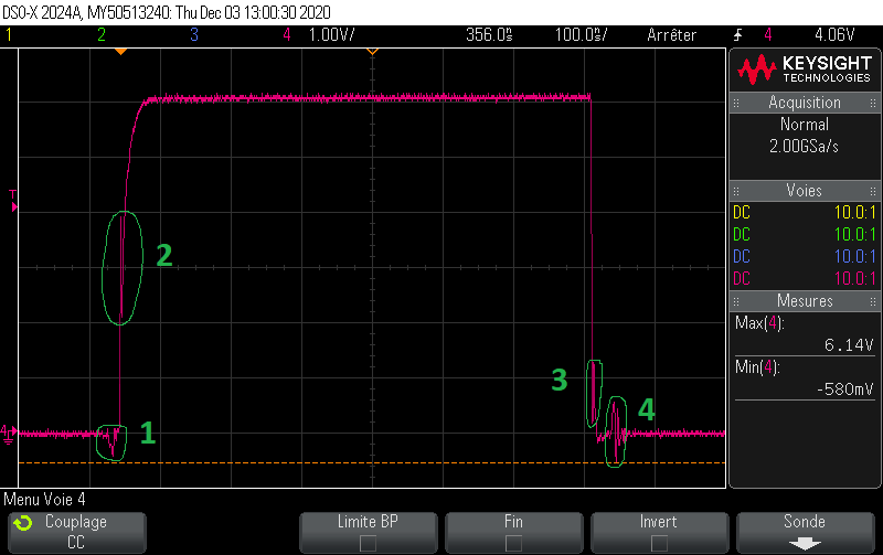

    However, I'm checking the signals at LODRV, HIDRV, BTST and PH to ensure there is no problem here before testing stability with various caps and transcients. To perform mesurements I use single ended 300mhz probes with short return gnd spring, and a 200mhz scope.
    The tests points are on the bottom side of the board :
    - via under the thermal pad of the driver for GND
    - via just after the LODRV output of driver
    - via just after the HIDRV output of driver
    - via just after the PH output of driver
    I attached the layout to the post. MOSFET used are BSC094N06LS5 for either LS and HS.
    First time I made measurements, I noticed negative ringing (with Rgate=0Ohms, Rboot=2.2Ohms) but it was working fine, however I added 2.2R gate resistors on both sides to try reducig the ringing :
    For these measurements, Rg = 2.2 Ohms on LS and HS, Rboot = 2.2 Ohms :
    scope37 and scope38 : PH at Iout=0.01A
    scope39 : PH at Iout=4.8A
    scope40 and scope41 : HIDRV at Iout=0.01A
    scope42 : HIDRV at Iout=4.8A
    scope43 : LODRV at Iout=4.8A
    Ths most important undershoot is on HIDRV : on scope42 (high load) it goes down to -4V during some ns, and on scope41 (light load), it goes down to -1/-1.5V during 100 or even 200ns. That should be destructive !
    The datasheet gives limits -0.3V to 7V for LODRV, -0.3 to 39V for HIDRV/BTST, and -2 to 36V for PH. Although the positive limit is never reached, the negative limit is often reached and exceeded. I wish to know what limits apply for short pulses, to maintain device reliability.
    I'm surprised by the negative limit on HIDRV. When the LS mosfet is on and HS is off, the HIDRV pin is connected internally to the PH pin (driver off), why isn't the same limit that apply ? Same thing for BTST pin, during bootstrap charge, the bootstrap cap connect during a short time BTST to PH.
    Looks like I have a problem on my design, like mosfet switching too fast, or having unbalanced straight inductance on node connection ? I'm not sure how to proceed.
    I tried to check a new config with Rgate=0Ohms and Rboot=6.8Ohms, the self became very noisy, and I shut off the board. I restored the original config, and I still get the noise, and the HS MOSFET is very very hot. I will try to replace it by a new one and check.
    I hope your feedback will help me to investigate.

  • Hi Aurelien,
      Dee to trace inductance, layout, and via inductance, it is possible to see this undershoot. It is not ideal, so you might want to revisit the layout. The IC should be placed close to the switching MOSFET gate terminals, and the gate drive signal traces kept short for a clean MOSFET drive. You want to minimize the high frequency loop, which comprises of the capacitor at drain of HSFET, the LSFET< and the ground return path to the IC through which the source of the LSFET is connected.
    Negative undershoot occurs when LSFET is turning on and HSFET is turning off. Theoretically you would want to slow down turn on of LSFET or turn off of HSFET, which RBOOT does not do (slows down turn on of HSFET).
    What is your charge current? It looks like the charger is attempting to operate in DCM for some reason, which should only happen at light load. The PH switching node waveform is not expected.
    HSFET getting extremely hot is directly attributed to layout as well.
    Revisiting layout is key, as lots of these issues are not expected IC behavior and can be attributed to layout

    I already gave the current values in my post. The first PH screens (scope37/38) correspond to very low load (10mA). I'm wondering about the sinusoidal signal on scope37 and the triangle ondulation on scope38 that seems to fit the compensation frequency (range of 15kHz approx) Is it normal ? Is it dangerous ?
    The PH node at Iout=4.8A is scope39, it looks good except undershoots.
    When the HSMOS became too hot, it was only when I increased Rbtst to 6.8R instead of 2.2R (nominal value of your eval board is 2.2 Ohms), be carefull I don't speak about gate resistance, only bootstrap resistance. I guess it became hot because of lowered gate voltage (bootstrap cap not enough charged) and lower rise time, so took more time in transition region. However I cannot be sure of that, not enough time to make the measurements :)
    In fact, when looking at the scope screens, it does not seems that the problem come from the gate drive itself, I already have a serie resistor of 2.2 Ohms. If you look at the last screen "scope43" that shows the LODRV signal, we see 4 remarquables moments (I added legend on this post) :
    -1- undershoot before LSFET Vgate rising. This is due to HSFET turning off, the body diode of LSFET insuring conduction before LSFET is activated.
    -2- when Vgate is rising, there is quick fall at middle voltage and then continue rising normally, finishing without overshoot. Looks like this quick fall is due to LSFET switching to conductive state, mean a big current that create this shoot due to GND inductance.
    -3- Vgate falling is good, but when LSFET is effectively turned off, there is a spike, probably because of transition to body diode conduction
    -4- HSFET is turning on
    After reading some app notes, looks like the problem comes from very high speed mosfet choosen and layout weakness, not from the gate drive itself. I may try to use lower speed mosfet (but at cost of greater transition times, reduced efficiency and increased heat), but I think I will made a new PCB with enhanced layout should be better. My main interrogation come from the GND connection to the BQ24650. On your datashet and on your evalboard, the Power GND (thermal pad) is connected to a plane that connect together the GND of input caps, LSFET, output caps, etc... Of course I will keep a continuous plane between CIN, LSFET and COUT, but should it be a good idea to connect the PGND of BQ24650 directly at the LSFET Source pins? That would avoid undershoots caused by the GND plane offsets during high current transitions ? That leads to another question : on which plane should I connect the GND pin of the VCC filtering capacitor : on the common power GND plane, or on the GND plane of the thermal pad (connected to LSFET source) ?
    Can I have information about the lowest voltage accepted on LODRV, HIDRV, BTST and PH nodes during transcients pulses (<10ns) ? I guess there is a tolerance, else my first prototype should have exploded instantly...
    Aurelien
