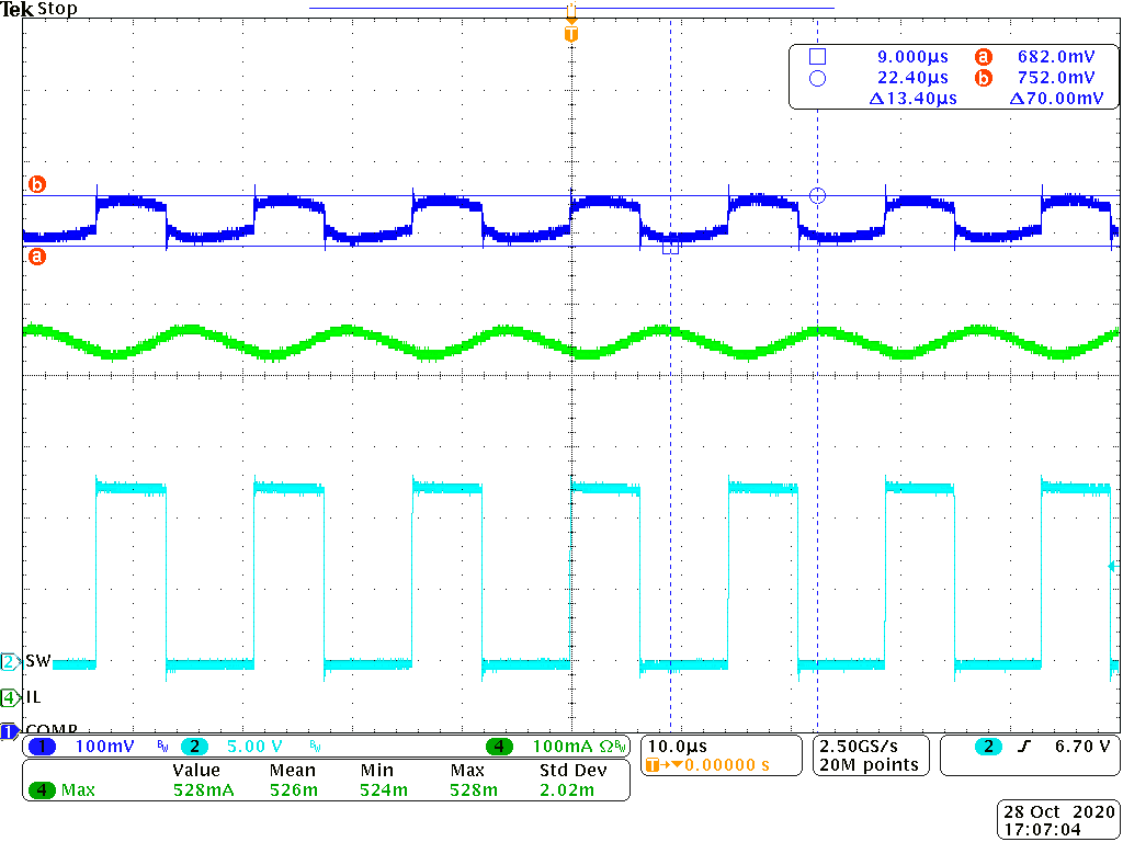

The COMP pin is always 0.6V, and the IC does not exit pulse skipping mode until the load current is more than 0.7A.
And there is large voltage ripple under pulse skipping mode, the SW frequency is set to 271kz, but in pulse skipping mode, it switch as burst of 271khz pulse with around 20khz frequency.
The input voltage is between 22 to 29V.
More details
I have two version of board using TPS5405, both board is exactly the same circuit and PCB layout, except one has add some resistors and other IC, the total additional load is about 30mA (the new board).
The COMP pin of both board is always 0.6V
New board's voltage ripple is larger than the old one.
I could hear acoustic noise from inductor and capacitor of the new one.
New board exit pulse skipping mode when the load is above 600mA, the old one exit pulse skipping mode when the load is above 400mA.
I already tuned the compensation circuit of the new board, it is a little bit better.
But what cause this problem? Why the COMP pin's voltage does not works as datasheet specification?

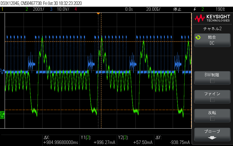

    This is the waveform,sorry I don't have current probe in hand now so cannot capture inductor current.
    And I changed the components value.
    wave.xlsx
    I know it is a power unstable problem, but what cause it unstable? and why the COMP pin always 0.6V? Why can not leave pulse skipping mode at around 300mA?
    By the way, theTPS5405 datasheet is very simple and crude, which make me worry about if there is any problem on the IC itself.

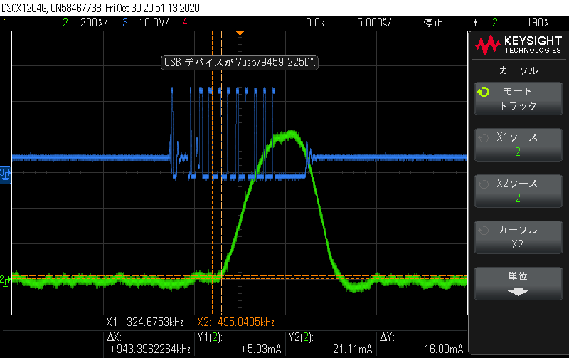

    I don't know why you said the COMP vary even I upload that much waveform (yes it vary a little bit, but always above 0.5V)
    I did observe the same COMP voltage above 0.6V ,even the device entered SKIP mode(min COMP voltage, CCM:682mV,ECO:616mV).
    But devices will enter SKIP mode when peak current below <300mA typical.
    CH1:COMP;
    CH2:SW;
    CH4:Iload;

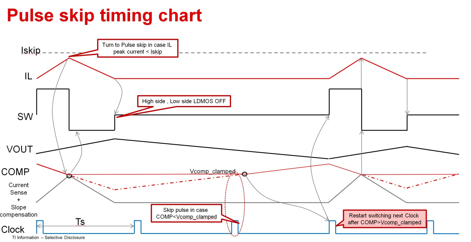

  • Hi ,
    For the comp voltage , it should be some history here and no idea why it was described as 0.5v in DS. Sorry for any misleading .
    For the ISKIP (current skip exits / enter ECO mode), it should be around 300mA . And It was confirmed on ECM board.
    But there is something may mislead you .
    The light load running includes DCM operation and Eco-mode operation.
    As the output current decreases from heavy load condition, the inductor current reduces as well and eventually comes to point that its rippled valley touches zero level, which is the boundary between CCM and DCM. The low-side MOSFET is turned off when the zero inductor current is detected. As the load current further decreases, the converter runs into DCM.
    At even lighter current loads, Eco-mode is activated to maintain high efficiency operation. The On-time is kept almost the same as it was in the CCM so that it takes longer time to discharge the output capacitor with smaller load current to the level of the reference voltage. This makes the switching frequency lower, proportional to the load current, and keeps the light load efficiency high.
    I think 600mA you observed is around DCM margin arear(not in eco mode actually)  , you can see a obvious speedstep frequency as figure 7 shoen in DS page 6.

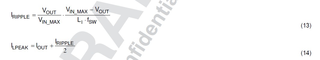

    Assume the ISKIP and comp voltage is constant , also the application is fixed .From below equation ,we can see that lower frequency bring in large Iripple , which will be more easy to trigger ECO mode .

    Thanks for the formula.
    What you said and the formula make sense to me, but what happened is quite the opposite. The regulator leave ECO mode easier in low frequency than high frequency.
    Edit: Sorry, one misunderstand here. So the regulator detect only the peak current instead of monitoring the whole ripple current to operate in ECO mode? Which makes more sense to me now.
    Yes , the integrated current comparator catches the peak inductor current only. So lower load current  can leave ECO at low frequency mode than high frequency , because it has larger ripple .  when increase load current step by step from eco mode , low frequency setup should exit eco mode earlier than  high frequency .

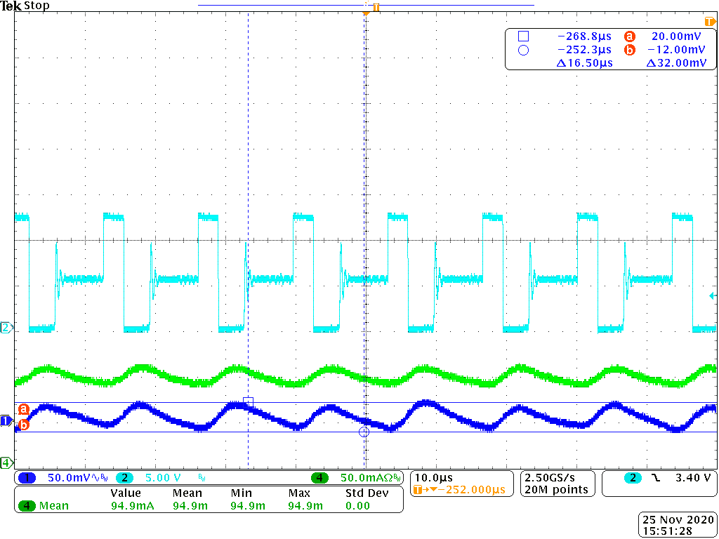

    Here is the 400mA load waveform.
    Vin = 29V, Vout = 5V, F = 271000, Iout = 0.4A, L = 0.000022
    Use the formula you provided, Ipeak = 0.4 + 0.69/2 = 0.75A
    Use the formula 4 in datasheet (delta I in terms of load current), Ipeak = 0.4 + 50e-6 = 0.4A
    Both case should leave ECO mode. But it did not (the red area if I am correct).

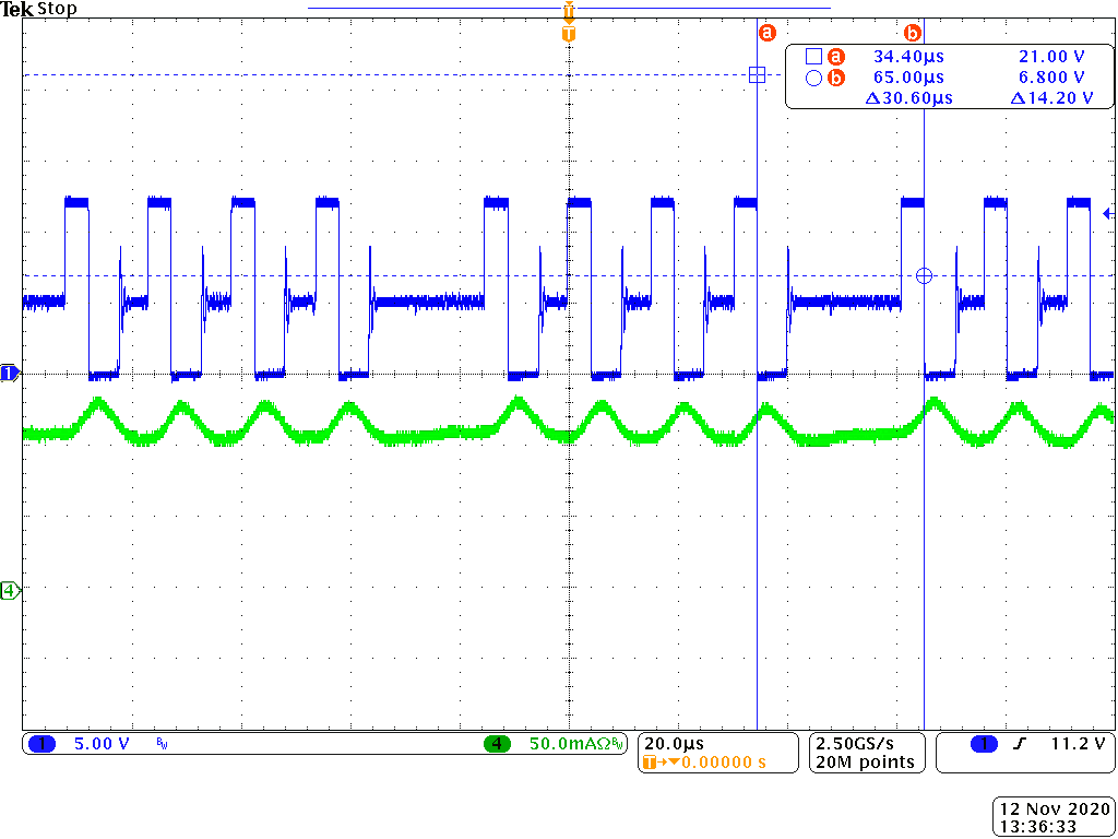

    By the way, you said the regulator would operate in DCM mode in light load, is it the green area?
    How does it determine when is CCM mode and when is DCM mode.
    The waveform you attached is not in ECO mode I think. It jumped between CCM and DCM mode, and the red area should be in  DCM mode.
    For the reason I think should be the internal sensor voltage not so good to tell apart DCM/CCM . Better to see the current of inductor if the valley is above zero , and we can easy know if it is in ECO mode/CCM/DCM.
    BRs,
    Young

  • The higher the frequency I set, the larger and smother the current wave I get, the boundary did not change at all.
    How the regulator determine DCM mode?

  • Hi Young
    Ye it is inductor current
    It looks good at 1A load, but what happen at 0.1A?
    1A
    0.1A

  • Hi Young
    FB trace is wired from C202 to R201 in the PCB.
    I expect your output voltage would be very clear. Just want yo confirm.
    Attach the Vout waveform as below.
    and the layout seems good to me. That's wired about your obversions , would you like to ship one board to us for further check ?
    Aand I will close this topic first , as we can talk this offline . also attach my mailbox  (young-zhao@ti.com)if there is any other support here.
    thanks for understanding .
    CH1:VOUT(AC)
    CH2:SW
    CH4:IL
