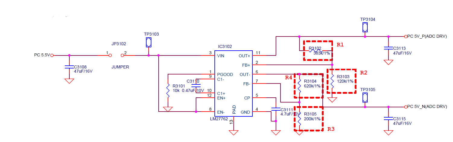

First of all, we want to get output voltage of +5V and -5V with input voltage of 5.5V. So, we designed schematics as below(Fig. 1).
Fig.1 Schematics_New
However, the output voltages are +4.6V and -2.6V (or +0.6V) respectively whenever there is load or not.

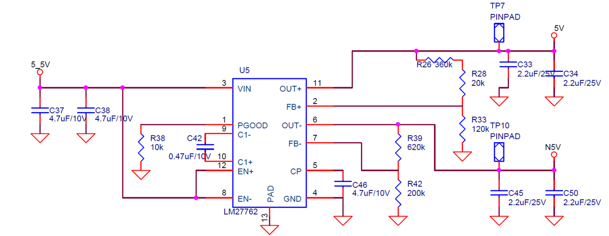

I already used same schematics for our previous system as below (Fig. 2) and it worked well.

The differences between Old and New one are these;
  1. Input capacitor value - old:4.7uF x 2, new: 47uF
  2. Output capacitor value - old: 2.2uF x 2, new: 47uF, although we’ve changed this same as old one, it still doesn’t work

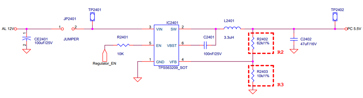

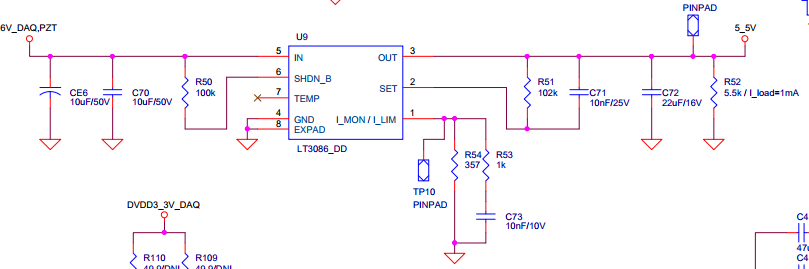

  3. Driving circuit – old:LT3086(Analog Devices), new: TPS563209(TI)

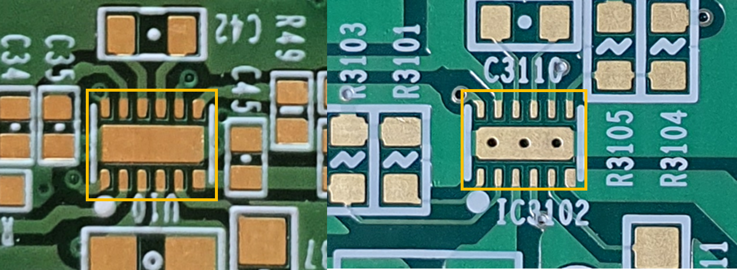

  5. Foot print size – slightly smaller than before
Fig. 3 Driving circuit; Old:LT3086
Fig 4. Driving Circuit; New: TPS563209
Fig. 5. Foot print

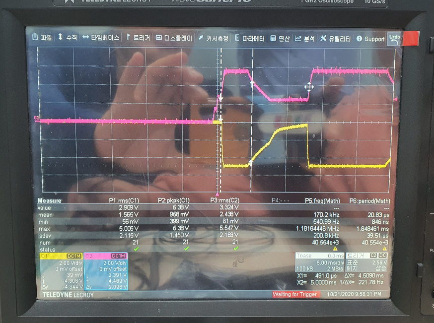

When it is not working well, we checked transient waveform of output and input of LM27762 as below (Fig. 5). Here, transient means that when we apply enable signal to driving circuit.
Fig. 6. Transient waveform of LM27762, input(Red) and negative output(yellow)
As you can see from fig.6, the input fluctuates when the negative output fluctuates.
This abnormality is not always happening, but it shows frequently. That’s why we are not able to figure out what the clear cause is.

    From the new schematic, I see that you have used a very high input and output capacitance compared to the old schematic. As per the operation principle of charge pumps, the energy stored in the input capacitor is transferred to output capacitor through Cfly. In this design, Cfly is too small compared to the others. Hence the energy transfer will not be correct. If you change any one external capacitor, the others should be modified accordingly. I suggest to keep a lower Cin & Cout as per d/s recommendations.

  • The new board has longer and thinner traces. The layout guidelines in section 10 of the datasheet are important.
    The fluctuating input might indicate that the power supply can not supply enough current. Maybe the board around the TPS563209 has similar layout problems.
