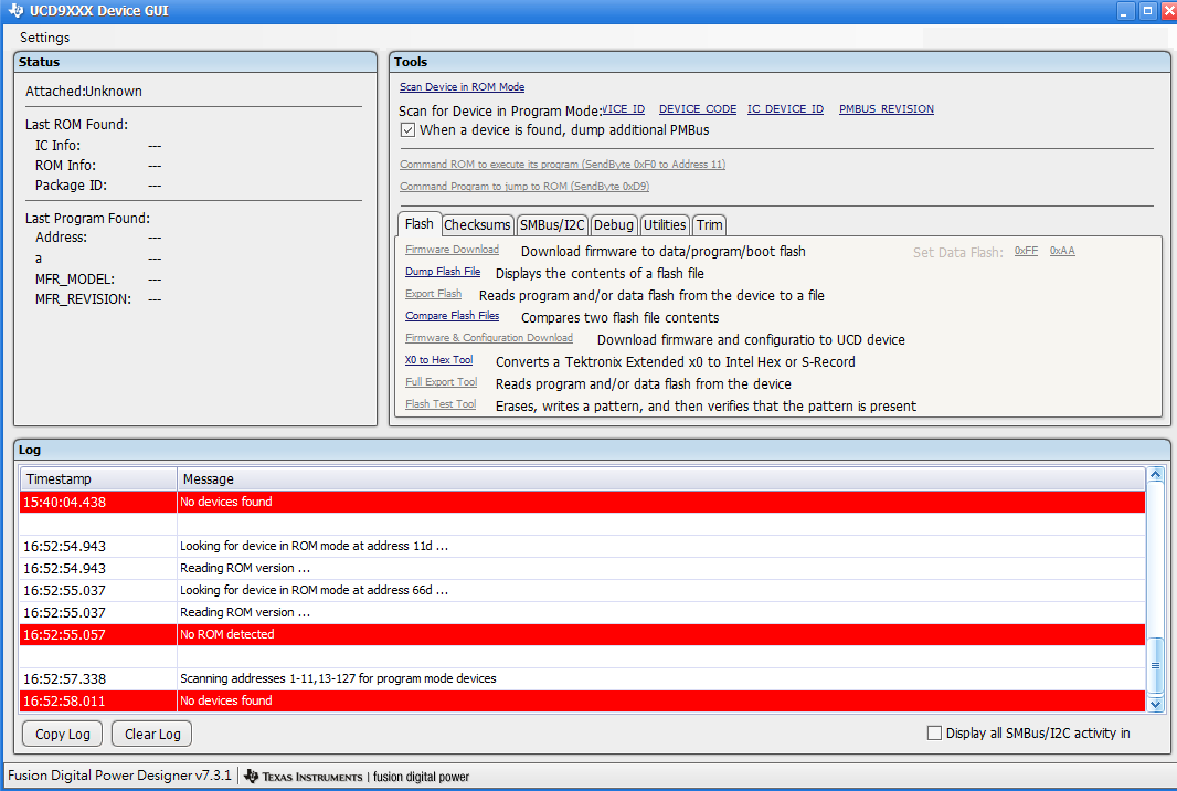

We are currently going to programming UCD9090

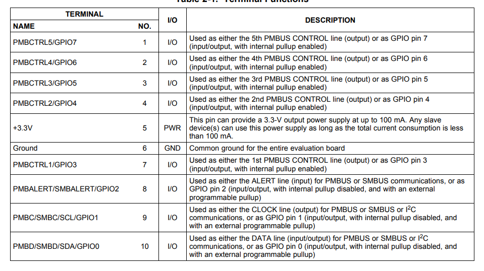

The tool we use is GPIO-TO-USB
After we connected the circuit, the software GUI could not read the IC
I would like to ask if there are missing components?

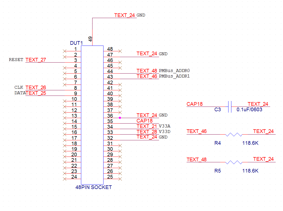

The following is the circuit diagram and wiring way
TEXT_24 -> GND
TEXT_21 -> PWR
TEXT_28 -> PWR
TEXT_26 -> SCL
TEXT_25 -> SDA

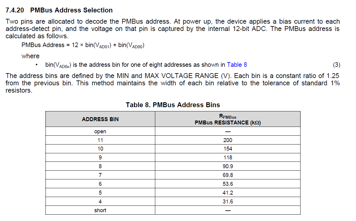

Both ADDR groups are connected to 118.6K resistors

    In order to communicate with USB-TO-GPIO dongle, only GND/SCL/SDA pins are needed. there is no need to provide power.

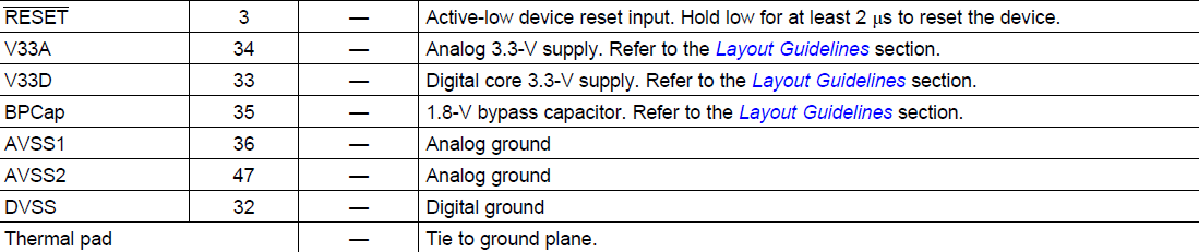

    Have you probed the V33D/V33A/BPCap/Reset? BPCap shall be around 1.8V if device is functional?
    Moreover, if UCD9090 is functional, it shall consume about  55mA current. Do you have a way to check this?
