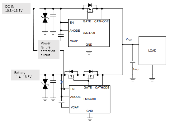

We are considering the following circuit configuration.
Does the LM74700 support the usage shown below?
Please tell me any notes or concerns regarding this usage.

Hi Yusuke,
What is the current level in each path ?
LM74700 does not support priority power-muxing as GATE cannot drive back-to-back FETs. Please use LM74800-Q1 as per figure-15 in https://www.ti.com/lit/an/slvaes2/slvaes2.pdf

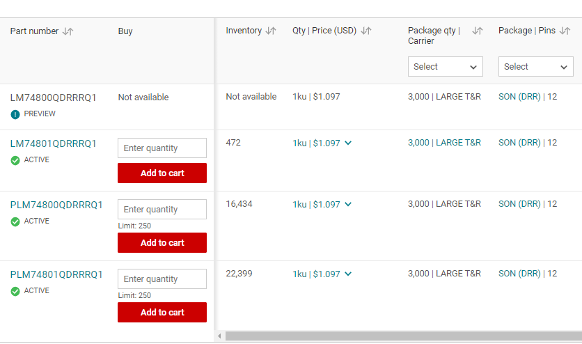

Hi Rakesh,
Thank you for your kind response.
The "SLVAES2 material" made the customer interested in LM7480X.
However, the LM74800 is a preview product.
Could you tell me the details of the LM74800 development schedule and RTM schedule?
