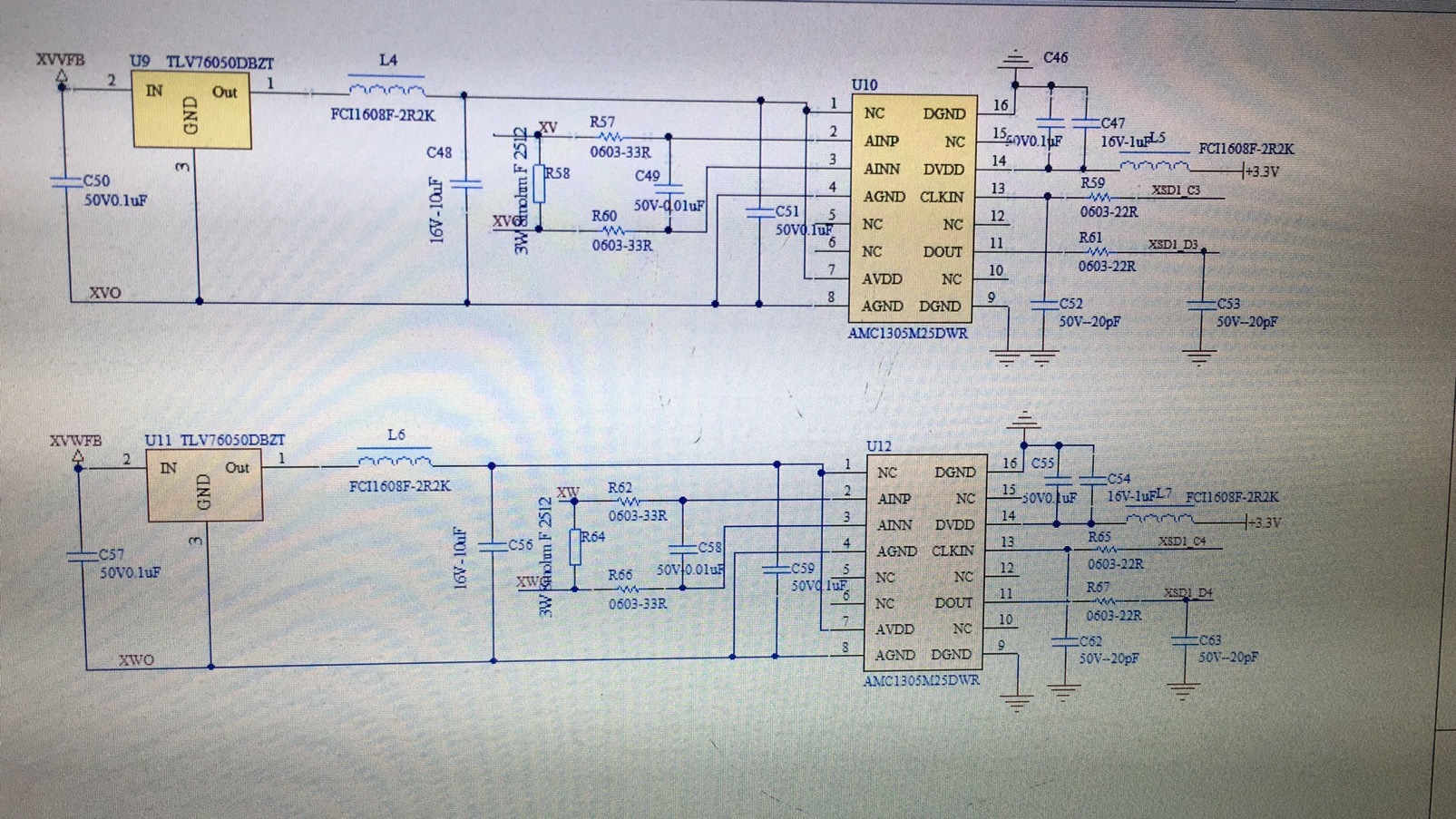

Hi team,
My customer use TLV76050DBZT to translate 17V to 5V, and 5V just power for 1pcs AMC1305. Below is their SCH.
But at sometimes, TLV760 output shutdown 1ms and then recover. We test the input voltage 17V is stable. So it is output problme.
We guest it have over current or over temp shutdown, Due to AMC1305 current is small, so it should not over current.
Do you think it is over temp shutdown or other issue?
