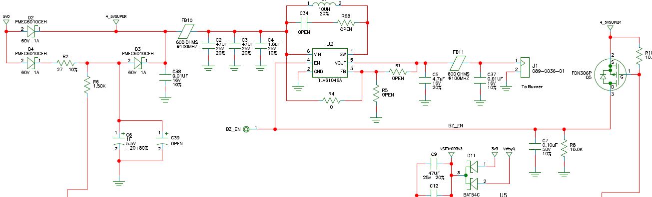

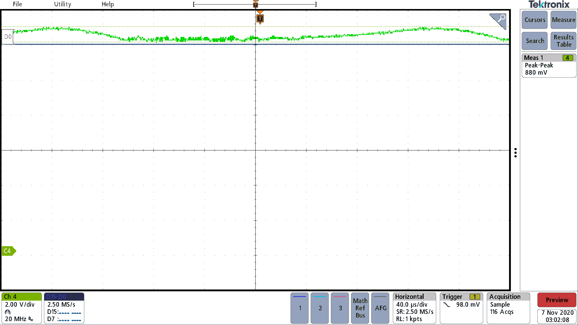

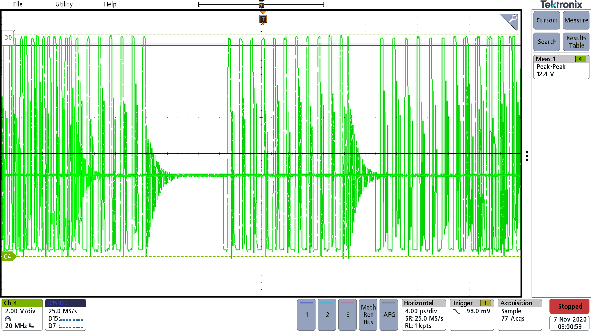

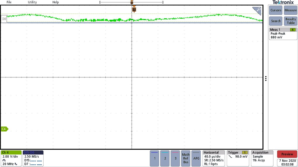

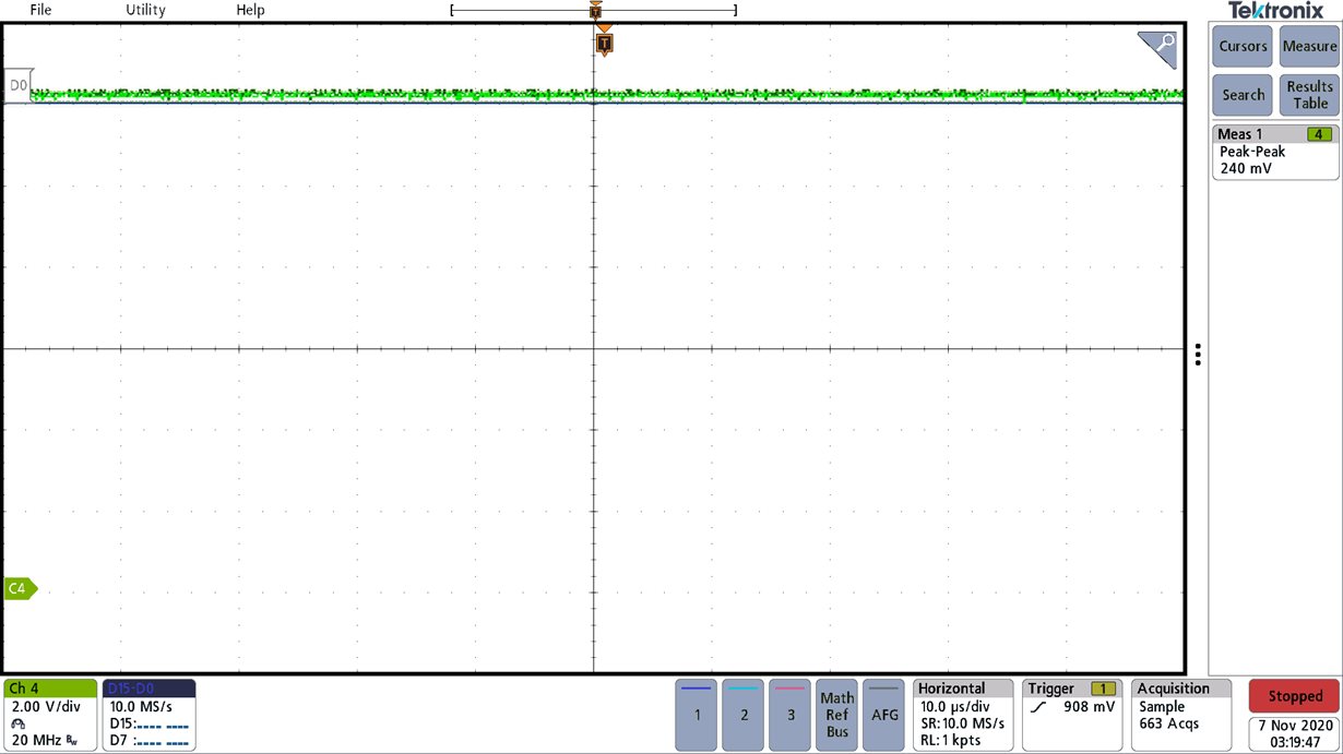

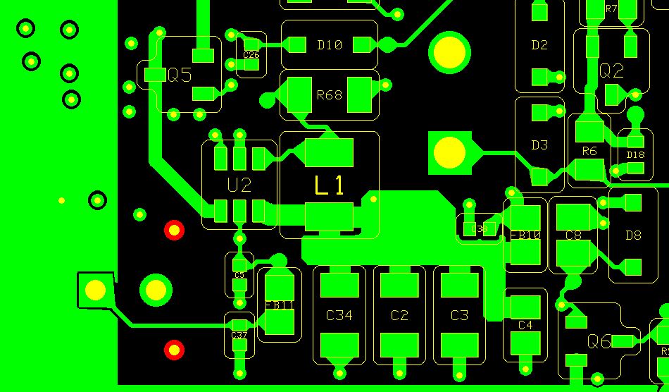

Hello, I am using the TLV61046A in the circuit attached. We are driving a small piezo buzzer, Mallory part PK-27A35WQ. I have found that two of these devices have blown (out of our initial buy of 20 boards) and are non functional in the circuit. Our circuit is simply the application circuit as described in app section of data sheet and the demo board. Do you see anything we could be missing with the circuit or any problems? This is for a medical device. We have replaced one with a new one from Digi-key and it is now functional. Should we save the other defective one for your analysis? We need to rectify this as soon as we can. Thanks for your assistance.
