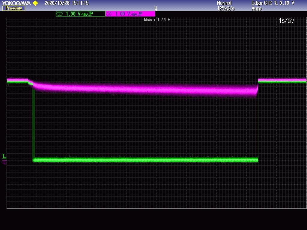

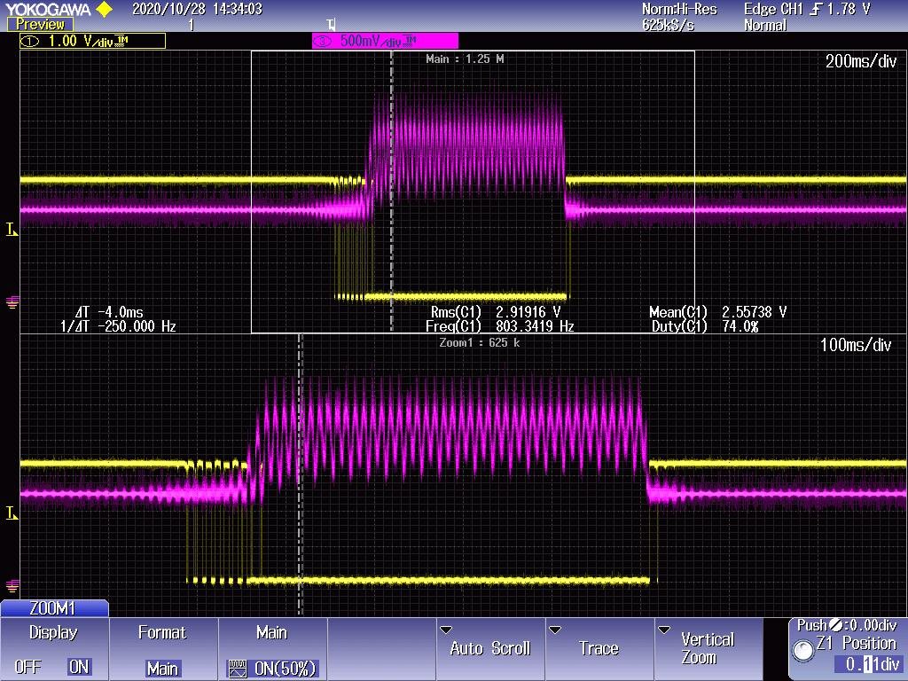

I started having a look on what could have happened and I found that, If I place my finger near the IC, suddenly a quite big oscillation in the 1V2 rail occurs (here yo can see both 3V3 and 1V2):

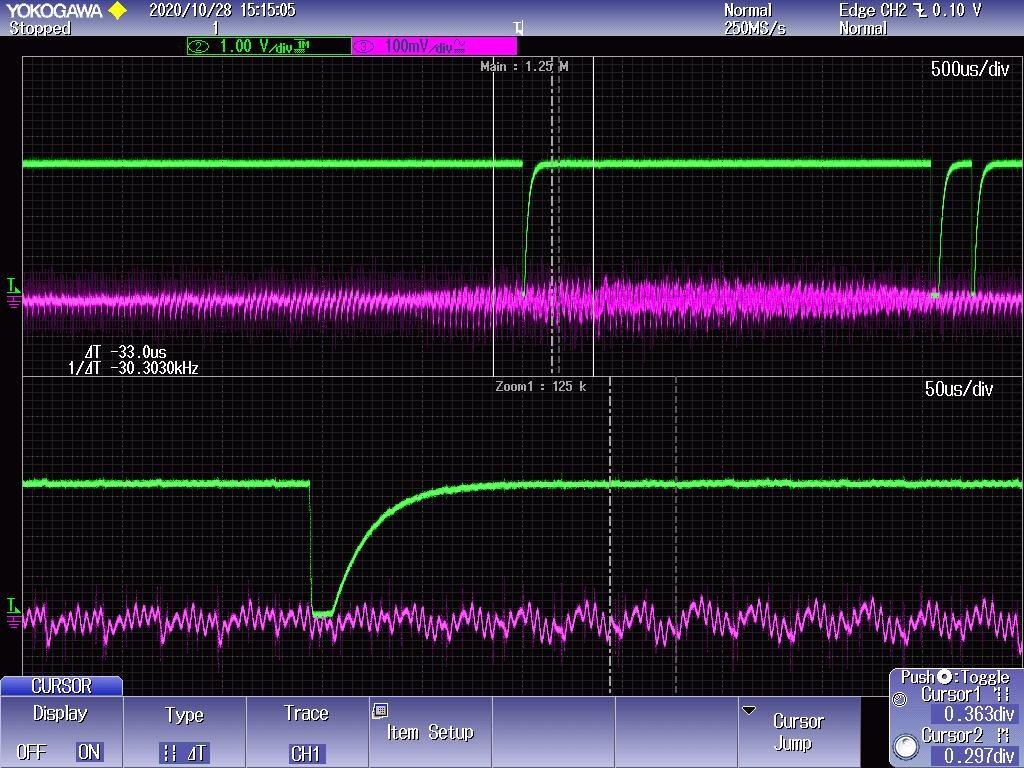

This obviously makes that the voltage supervisor originates a Reset in the MCU. Here you can see the 1V2 rail (purple) and the XRSn (output of the TPS3702CX12DDCR) in yellow. It is always a 100 Hz oscillation.

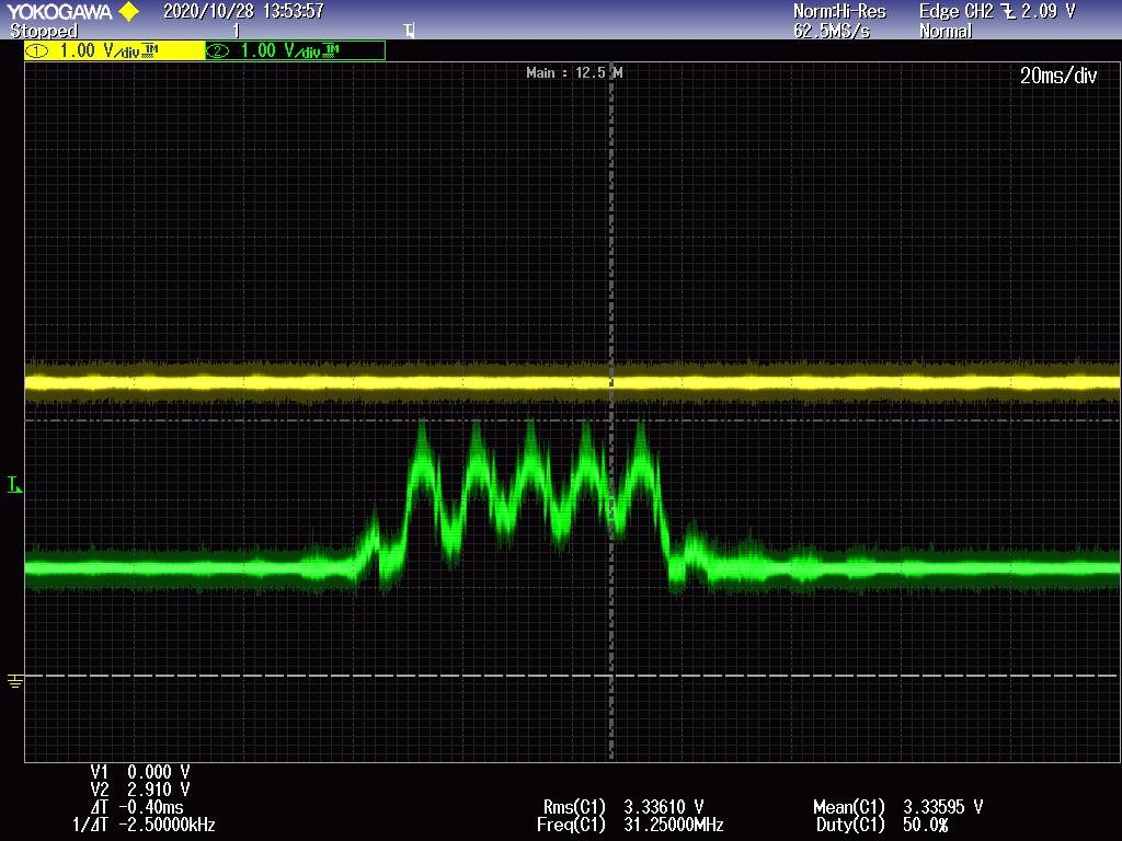

Since I thought that it could be somehow related to the layout of the board, I performed the same test in the Evaluation board of TI (with a 28379D MCU) and it happened exaclty the same, but this time related to the 3V3 and not to the 1V2 rail. If I place my finger around the TPS62420, it seems that the Buck starts to work wrongly and force a reset of the MCU

    It happens when I touch the IC and/or surrounding components with my bare finger. What it happens (in my board) is that the Vout (only the 1V2 (SW2)) oscillates at 100 Hz and reaches up to nearly 3V.
    When I do the same (touching with the finger the area of the converter) in the TI evaluation board for the 28379D MCU it happens something similar in the 3V3. The MCU also resets. (See figures in first messages)
    If I touch the IC and/or surrounding components with something isolated (such a plastic pen for example) nothing happens, so I´m thinking in a capacitive related phenomena.
