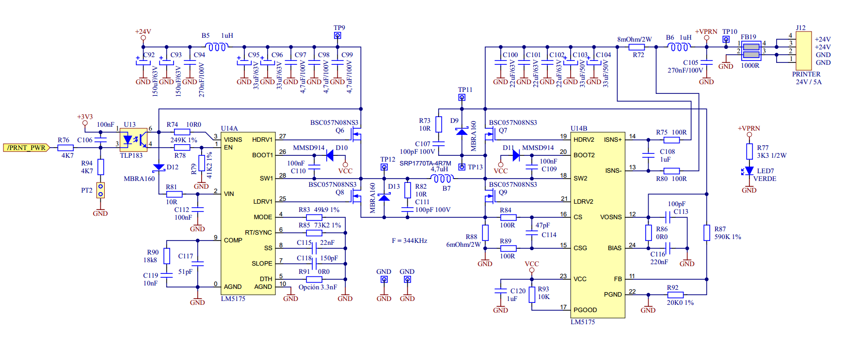

Dear e2e support,
My customer is facing some difficulties with the regulation of our buck-boost (details below).
The specifications are:
  • Vin from 9VDC to 36VDC.
  • Vout = 24V
  • Iout = 5A. Estimated peak power = 120W
The 24Vout is intended to power a thermal printer
Their schematic:

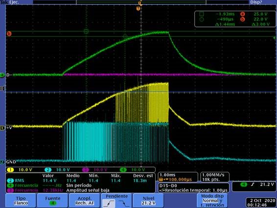

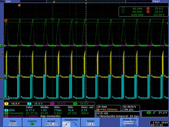

 Using a RESISTIVE LOAD
  1. Vin = 9V. It Works fine.
  2. Vin = 36V.  It Works fine.

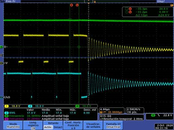

  3. Vin = From 22 to 20V (more or less) it doesn’t work fine, the output voltage falls down. The DC/DC controller seems not to recognize the right working mode (BOOST/BUCK), see the following diagrams:
Channel 1: TP13
Channel 2: TP12
Channel 4: Output voltage
  1. Vin = 20~22V. Reducing  the load to 10Ω, it already works fine.
  2. Vin = 20~22V. with 5Ω again and mounting a new SLOPE capacitor (300pF), it works fine.
  3. With a 450pF SOPE capacitor it works a little worse.

Could you share your recommendations / schematic review?
