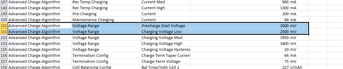

I have a problem with measuring the charging status of a battery in charging or discharging time.
Our company made characterization of our battery via TI(e2e.ti.com/.../811822 after that we got chemistry for our battery.
It solved some problems but now if we write new chemistry in BQ28Z610, our devices in discharging turn off after 30-20% and don't reach 100% in charge. Can anyone help with advice on how to fix this?
