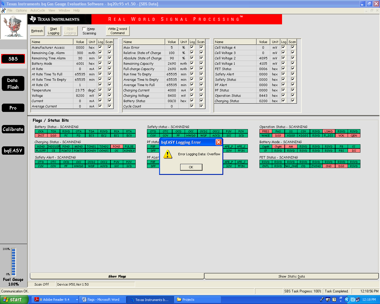

    Find the snapshot of the error message that is displayed by bqEVSW software.What does that mean?

  • Can you describe what you were doing in bqEVSW before you got this error? Were you using bqEasy? If so what step were you in?
    I was conducting a charge/discharge cycling using the bq20z95EVM-001 evaluation module, for a battery pack.
    Is this error is a serious problem?
    I am using bq20z95EVM-001 evaluation module.
    I have completed one charge/discharge cycle. At that point i also completed charging the 2nd cycle as well.
    Do we have to reinstall the software ?
  • I have not seen the error before. I would close and reopen the software and continue evaluation. If the error happens again, you will probably need to uninstall and then reinstall the software.
