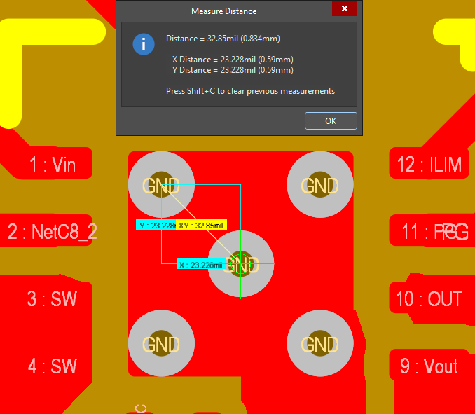

Hi Shaquille,
There is no critical restriction for the thermal vias. But I can provide you the thermal vias parameters on EVM.
1. via hole size is 7.8mil, diameter is 20mil.
2. center via to corner via distance is 23.228mil, 23.228mil.
3. Five totally as below picture.
For any more technical questions, you can send emails to me.
