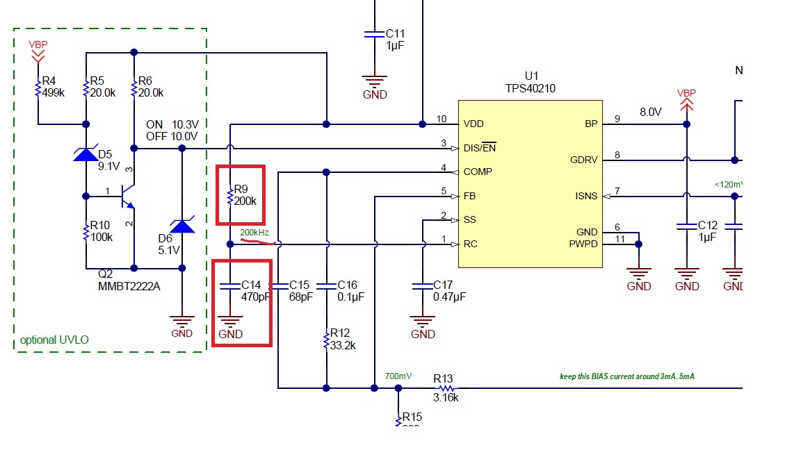

When we refer to PMP30308 reference design ,we can get Rt=200K and CT=470pf  and the frequency =200KHZ.

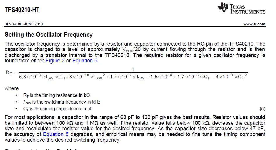

But when we use Frequency=200KHz and CT=470pf and Equation 5 as the picture shows
we can calculate  Rt= 183K Not 200K ,Is it right ? If it is right , when we want to get Frequency =1/3*200K=67kHZ then Rt=566K.

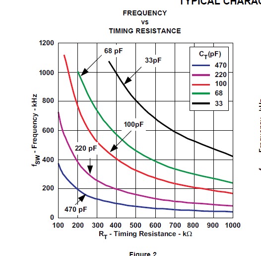

    I expect that the measured figure of the frequency is more accurate than the calculation formula.
  • Hi Brigitte
    1:The measured figure  of Frequency (Figure 2)  is not accurate , For the RT=200K CT=470pF, we can easily conclude that the Fs=200Khz, But when we want to get 67kHZ, it is not easy to get the value of RT from the curve .

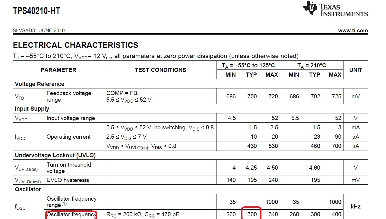

    2:For Rt=200kHZ and Ct=470pf , there are two different frequency 300kHZ (From data sheet )and 200kHZ(From PMP30308)
    How to explain this difference .
