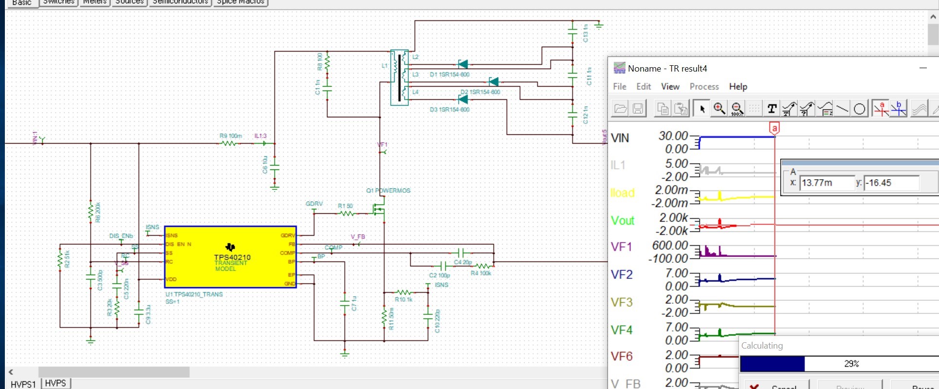

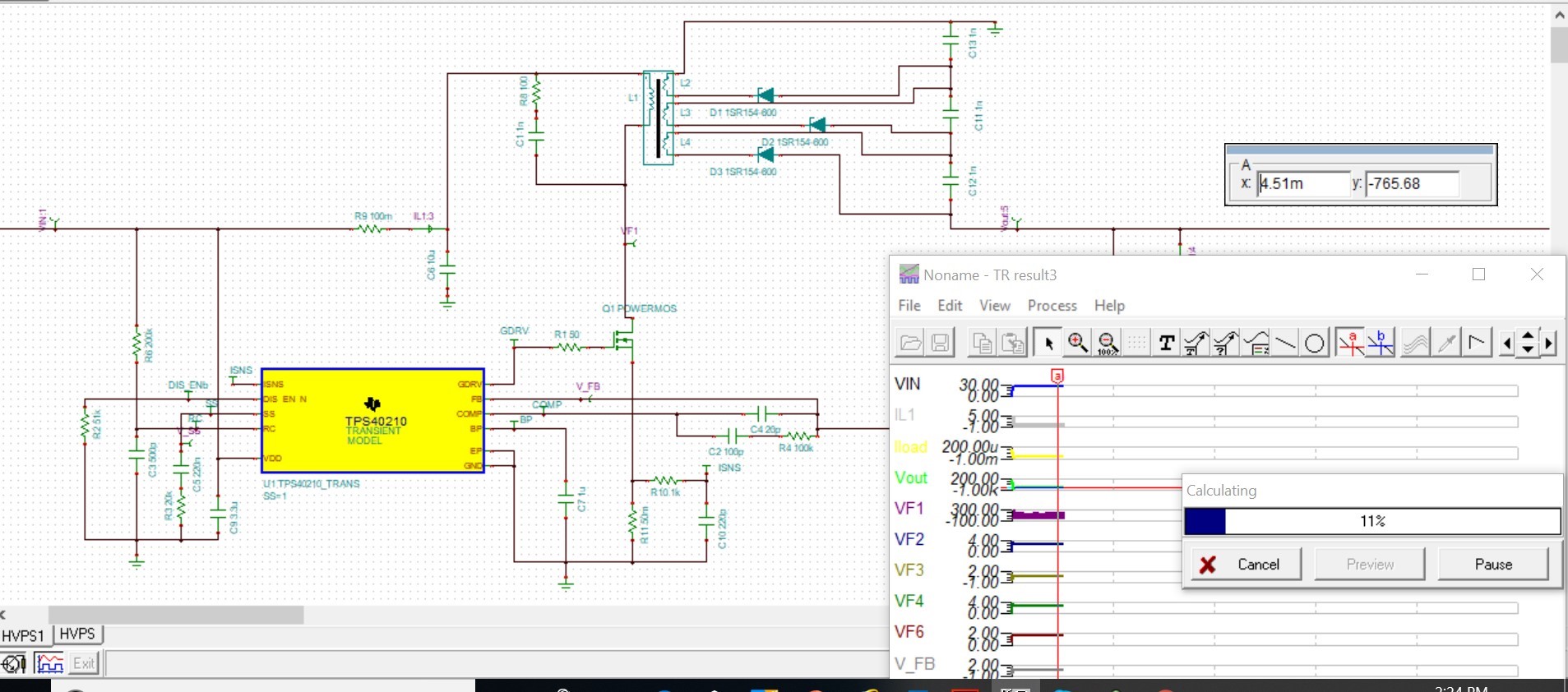

When we use tps40210 In fly back topology to generate negative 2KV , How to simulate the circuit if it can work with TINA
Hello lihua,

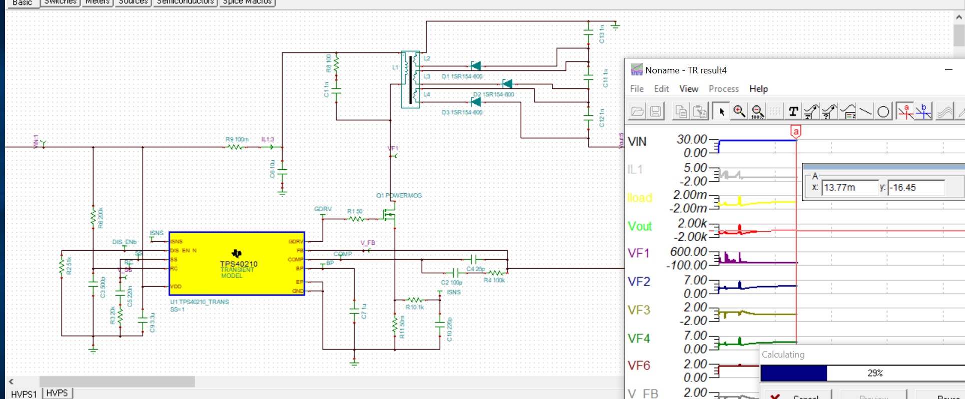

Please share either your TINA model or simulations of the different waveforms of all input and output signals as well as all pins.
On the other hand, please try different simulation methods and start values to check if this helps.

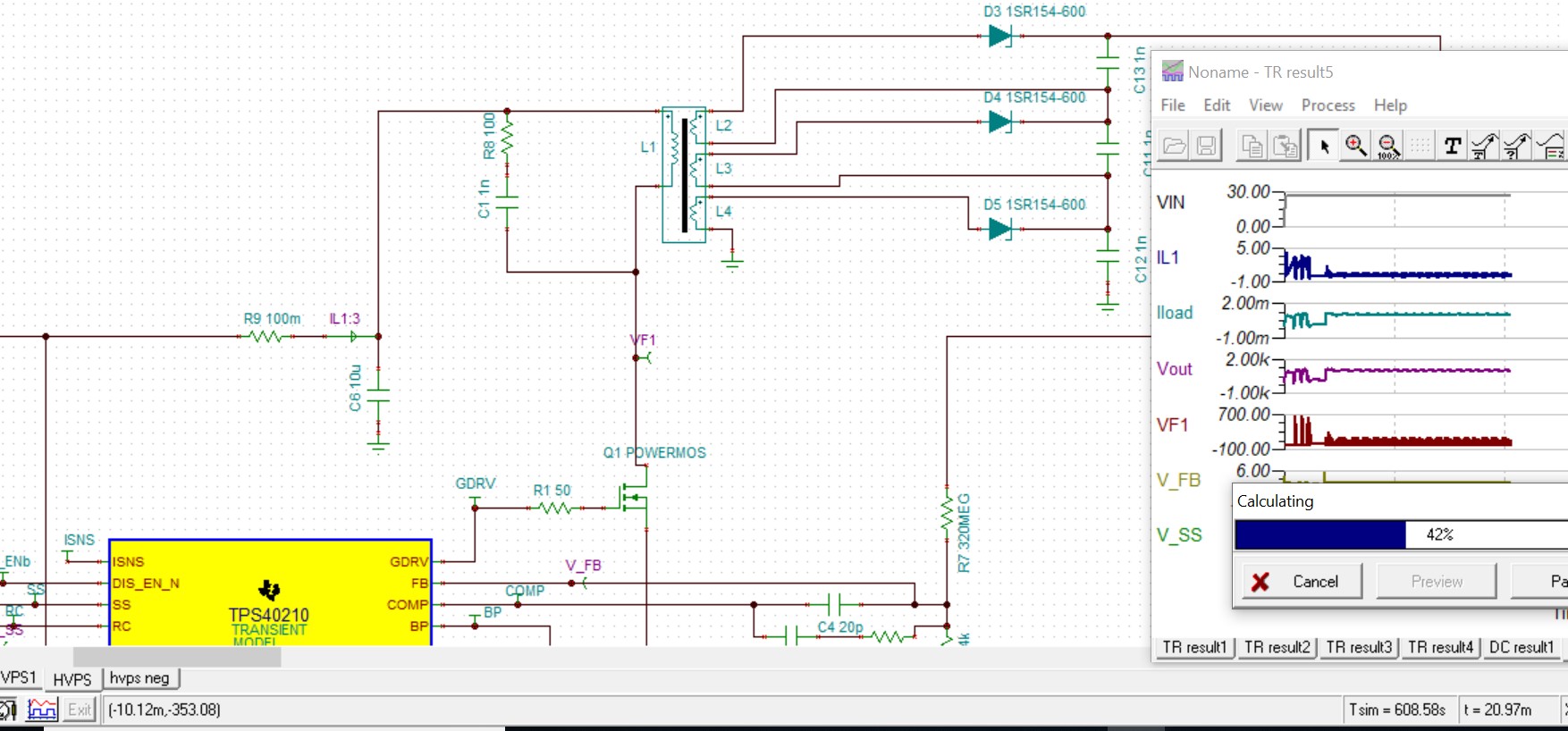

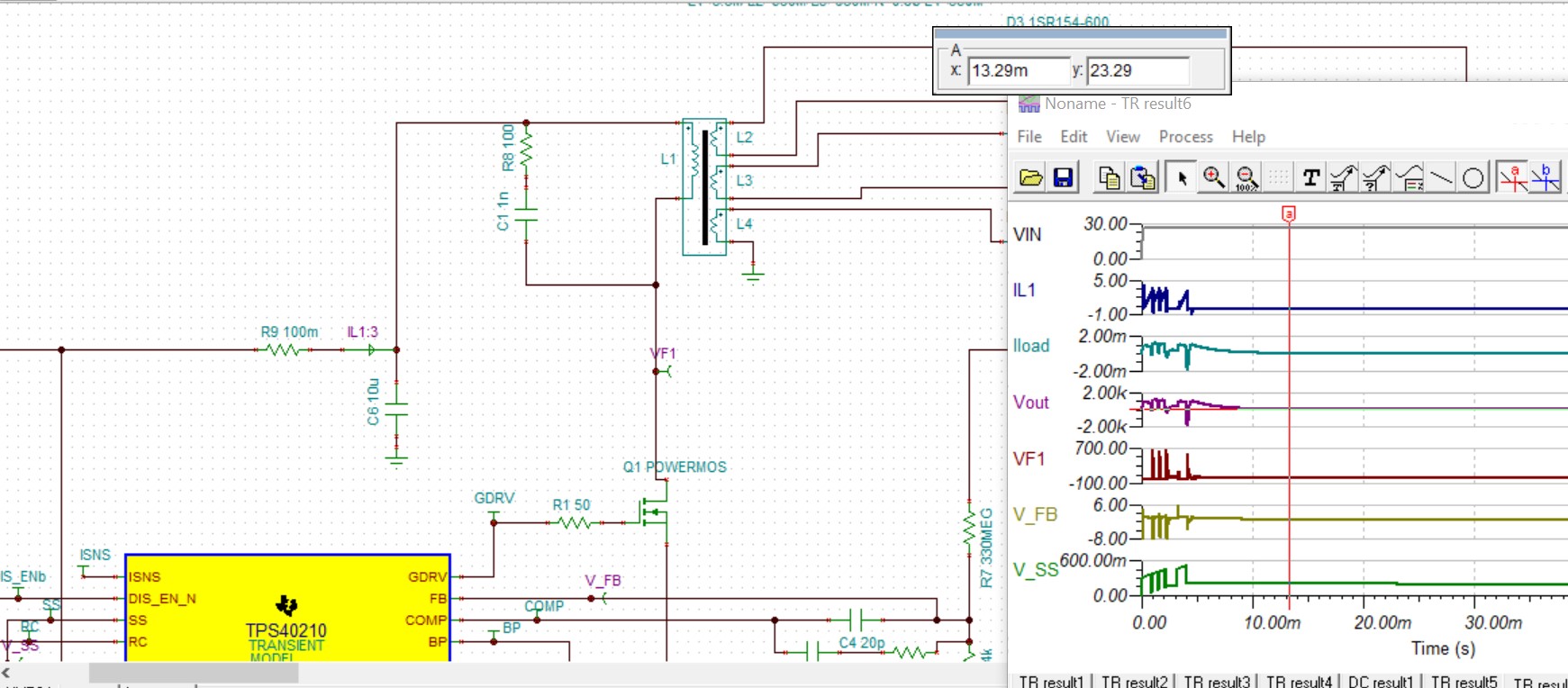

1:When we want to generate positive supply , we can adjust R7=320Meg, We can generate 1kv ,But when we want to modify R7 to generate higher Voltage ,The Output Voltage will decrease to 0V
2:when we Generate negative supply, Feedback circuit can generate -1kv with control Voltage 3.1V ,but when Control Voltage decrease to 3v ,The Out Put Voltage will decrease to 0

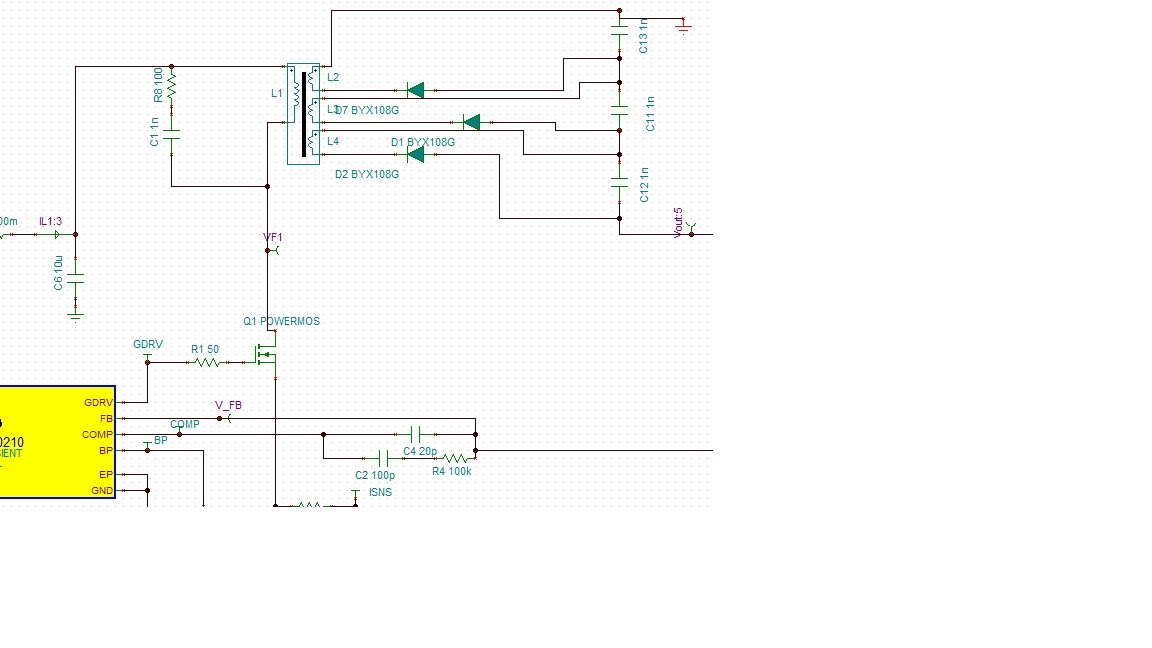

I observed that the question on the transformer dots is still open: Please connect the circuit on the secondary side the way that it makes sure that the orientation on the transformer is correct. The transformer orientation cannot be changed as this is a physical setup and then the pins would need to change as well. This is not implemented in TINA.
