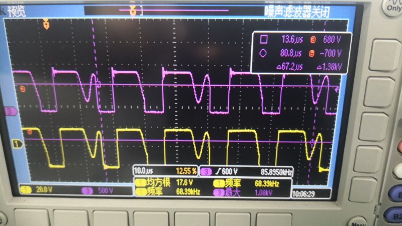

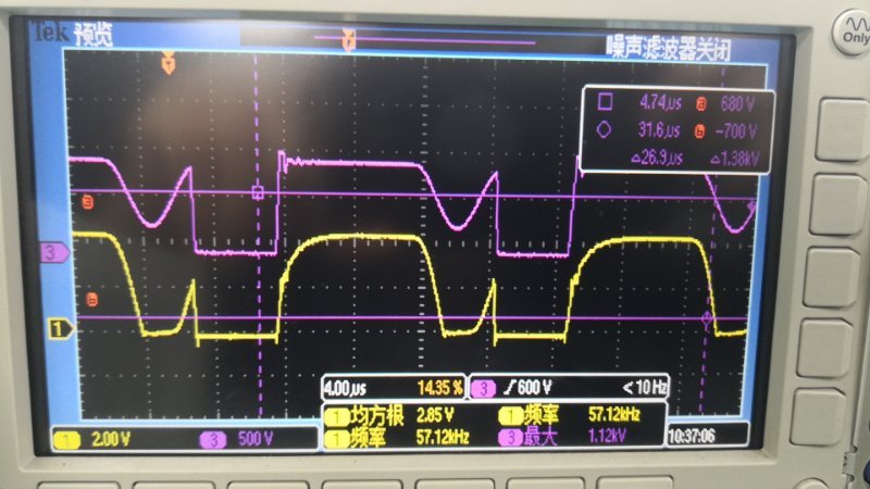

Hi Team,
  My customer now is evaluating UCC28704 for Aux-power supply design,  and they encounter an critical issue for the valley switching that valley-switching feature not realized and DRV turn on at very high voltage,  could you kindly give comments on how to fix this issue?
 The test waveform for VDS & Aux transformer voltage shown as figure 1, and the VDS & VS PIN voltage test waveform shown as figure 2,  from the 2 test waveform, you can see the DRV turned on at higher voltage but not the valley.
  Expect for your kindly reply, thanks.
Figure 1: VDS & Aux-Transformer Voltage
Ch1: Aux-Transformer Voltage; CH2: VDS
Figure 2 VDS & VS PIN voltage
CH1: VS Pin;  CH2: VDS
