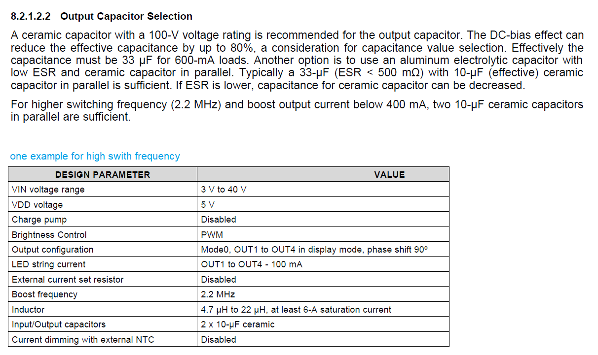

Hello Team,
Our new project need low profile capacitor ( height<4mm), so we have to change our original design 10uF ceramic+ 33uF electrolytic to all ceramic. From datasheet, I can see
For <400mA, two 10uF ceramic capacitors in parallel are sufficient. I would like to have your side to confirm if there is any request for these two 10uF and it’s really reliable for our  boost output 43V @ 25mA per string ( and we only enable one string each time) or not. Thanks in advance!
Many Thanks
