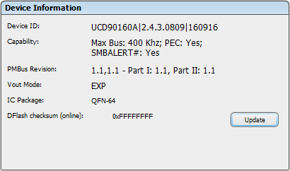

Dears,
I have update .csv file to chip via GUI and it's showing successfully.
But when I want to record this version checksum seems like something wrong because the number was 0xFFFFFFFF.
Why and how to created the correct checksum?

Hi
Please ignore the checksum shown in the snapshot, it is not useful.
If you want to confirm the programming is successful or not, please refer section 3.2 of www.ti.com/.../slua815b.pdf.
if you want to compare the data flash hex file, please refer section 3.3 of www.ti.com/.../slua815b.pdf.
