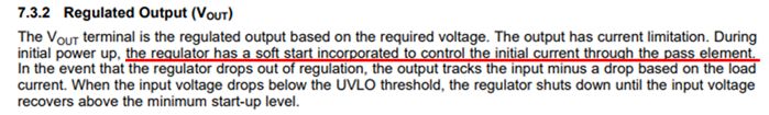

Is it sure incorporated a soft start?
"incorporated a soft start" is written pg. 10 of the datasheet.
But tSTR spec and Soft-Start Discharge on Functional Block Diagram are not written the datasheet.
And please could you tell me tSTR spec?
