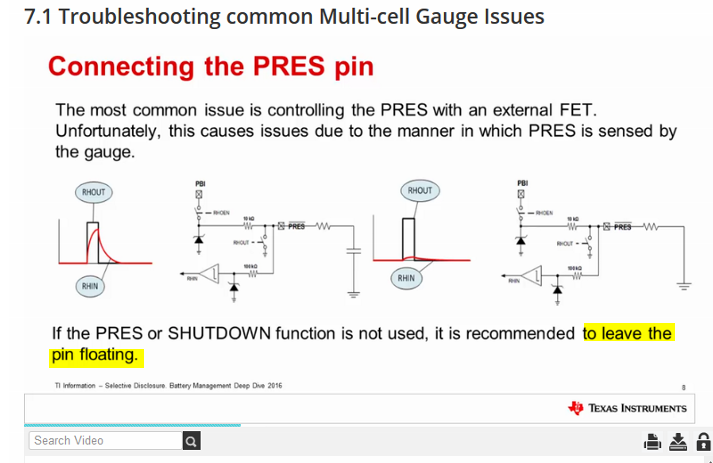

In the following training viedeo:
I have seen that an unused PRES and SHUTDOWN Pin should to leave open:

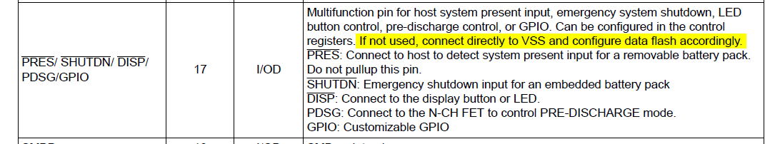

In the datasheet of the bq40z80 I found this:

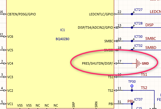

This I did in the schematic:
In the TechRef I found this:

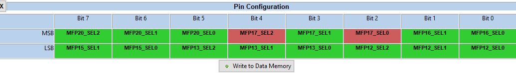

This is my corresponding setting of the dataflash:
3) What should I do? Connect do VSS or leave floting?
