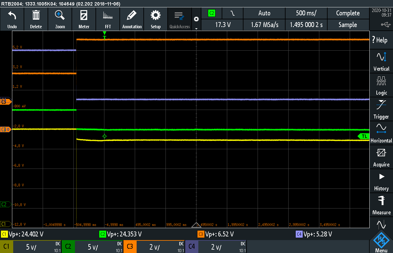

    1) Short-to-ground on OUT4 while OUT 1 feeds a resistive load - Scope shot of OUT1, OUT4, CS and nFAULT when I introduce the short between OUT4 and GND
    Yellow => OUT1 -- connected to a R = 300 Ω resistive load
    Green => OUT4 -- no load connected, used for short-to-ground
    Orange => CS -- monitoring CH 1 with SEH=0 and SEL=0
    Blue => nFAULT

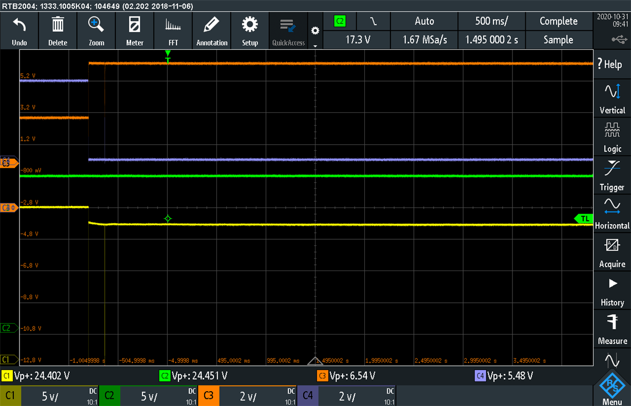

    2) Short-to-ground on OUT4 while OUT 2 feeds a resistive load - Scope shot of OU2, OUT4, CS and nFAULT when I introduce the short between OUT4 and GND
    Yellow => OUT2 -- connected to a R = 300 Ω resistive load
    Orange => CS -- monitoring CH 2 with SEH=0 and SEL=1
    Blue => nFAULT

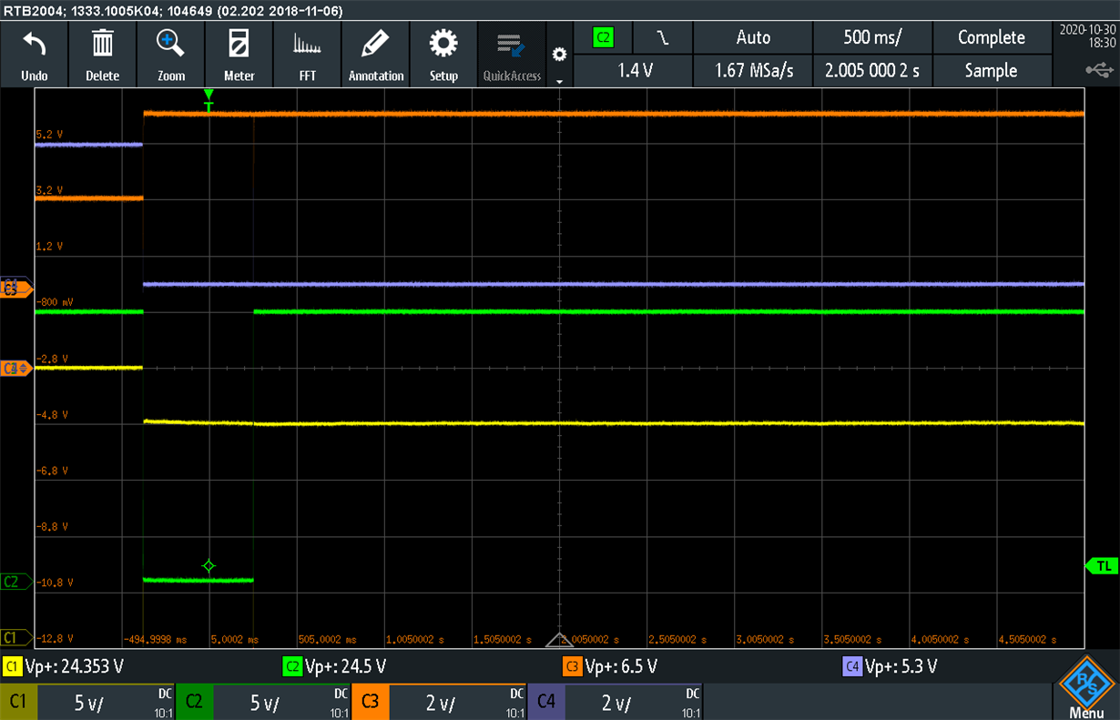

    3) Short-to-ground on OUT4 while OUT 3 feeds a resistive load - Scope shot of OUT3, OUT4, CS and nFAULT when I introduce the short between OUT4 and GND
    Yellow => OUT3 -- connected to a R = 300 Ω resistive load
    Orange  => CS -- monitoring CH 3 with SEH=1 and SEL=0
    Blue => nFAULT

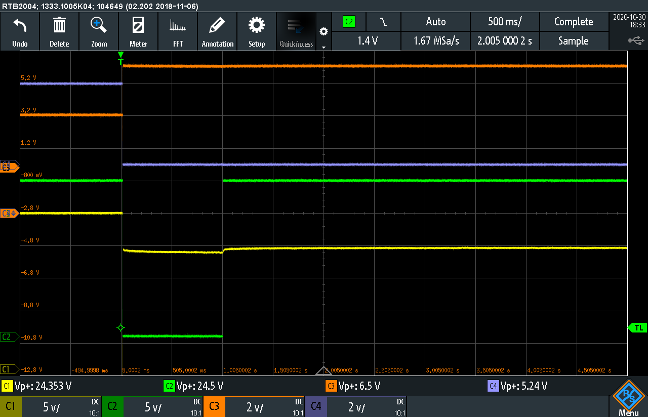

    4) Short-to-ground on OUT4 while OUT1 and OUT2 feed a resistive load - Scope shot of OUT1, OUT2, CS and nFAULT when I introduce the short between OUT4 and GND
    Yellow => OUT1 -- connected to a R = 340 Ω resistive load
    Green => OUT2 -- connected to a R = 300 Ω resistive load
    Blue => nFAULT

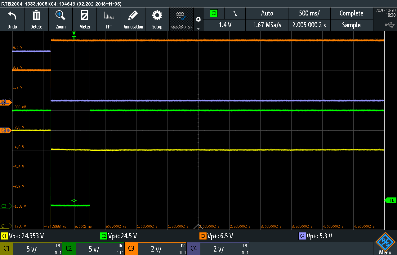

    5) Short-to-ground on OUT4 while OUT1 and OUT2 feed a resistive load -- Scope shot of OUT1, VS, CS and nFAULT when I introduce the short between OUT4 and GND
    no trace provided => OUT2 -- connected to a R = 300 Ω resistive load
    Green => VS supply voltage
    Blue => nFAULT

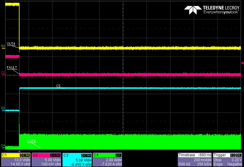

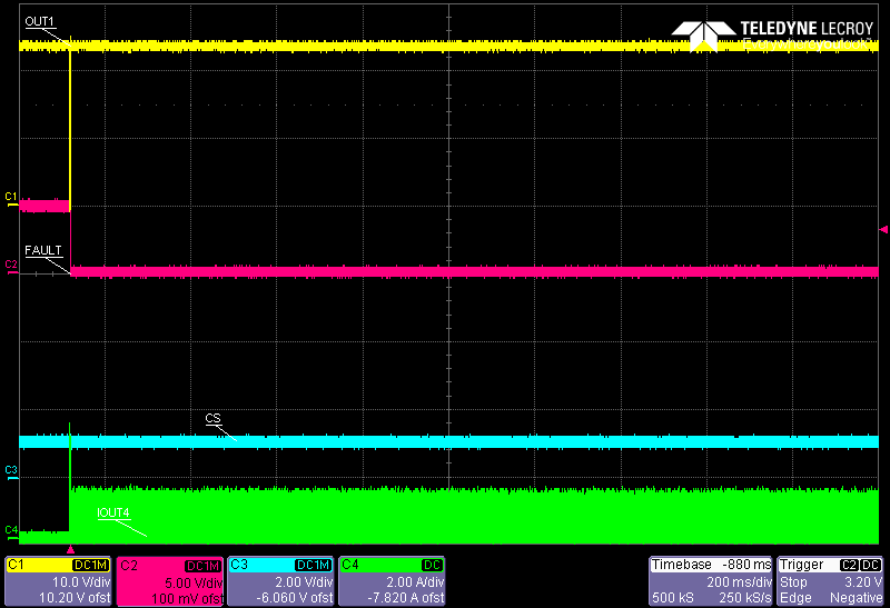

    I created your test setup in the lab and was unable to see the behavior you were experiencing.  Specifically what I recreated in your list was condition #5. On the TPS4H000EVM (B silicon populated) I was seeing that when shorting OUT4 to GND the CS when set to OUT1 was unaffected:
    When I put the voltage probe to OUT4 and set SEL/SEH to monitor on channel 4 the CS pin goes to the appropriate fault voltage:
    A few things to check on your end:
    • Are you sure there isn't some way you are increasing your current on OUT1 and partially shorting? It looks like your output voltage dips on VOUT1 when it shouldn't be affected by the short on VOUT4.
    • Could you monitor the current (if you have a current probe) on OUT1 during the fail condition?
    • Could you try to resolder the device and make sure the thermal pad is soldered correctly? If the thermal pad has poor solder coverage the thermal performance will be unreliable.
    • Could you share your layout so that I can double check it for any problems?
