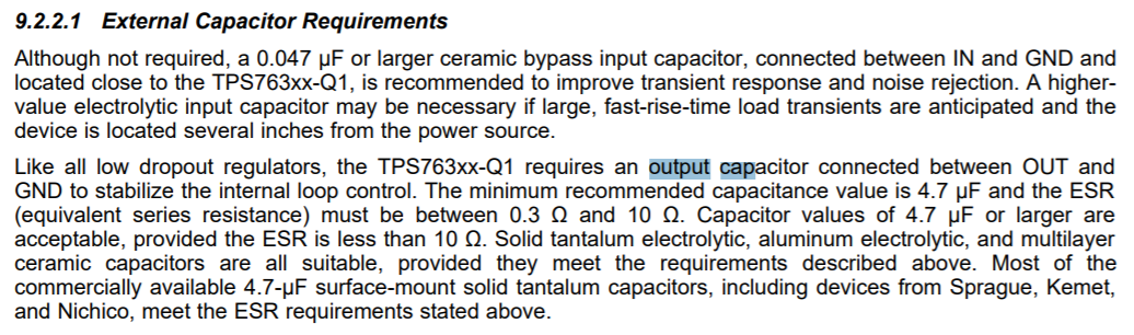

We are using this device to power ADS7951-Q1 and 2.5V Generator REF5025 devices. Additionally, it is loading 2 opamps, 4channel digital isolator and output section of AMC1311 device.
Load current expected typically is around 60mA
As the devices are placed in a high power switching application, we need to keep decoupling capacitors at the load side near to each power supply pin.
Could you suggest maximum capacitor we can keep near the source end and cumulative capacitance which can be kept near the loads?

    The TPS763-Q1 does not have a specification on the maximum output capacitor it can drive, but it needs to meet the following listed conditions:
    Please note when the LDO is driving large capacitance, the LDO may enter into the current limit or thermal shutdown during the startup. However, the detailed performance will vary depending on how much capacitance you have connected at the output pin of the LDO.

    ESR mentioned in datasheet is effective ESR (parallel combination) of all the capacitors connected at the output , correct?
    For experiment, we had connected around 100uF in total (all MLCC) at all loads and source and when we powered ON. Immediately, LDO failed.
    Could it be overcurrent during power ON?

    Yes, if you have multiple output capacitors, the ESR requirement is the combined effective ESR.
    We would need more details to tell what is causing the failure. Will you please provide scope shoot that clearly shows the Vin, Vout, Input current during startup and potentially to capture how the LDO fails?
