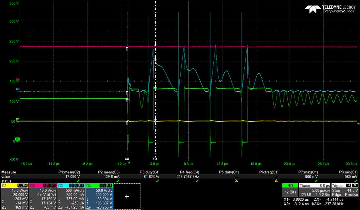

I am following the application report slua982 regarding debugging ACF converter start-up issues. I have the following waveform at 50% of brown-in voltage.
  • CH1 : voltage of the secondary winding (Vab in §6.2 of the application report)
  • CH2 : voltage of auxiliary winding (Vcd in §6.2 of the application report)
  • CH3 : not connected
  • CH4 : voltage at the switching node
I have identified 2 issues on that waveform that I can not solved:
  1. I have only 3 pulses instead of 4 and I don't get a 1.5s restart. It seems more like a reset every 60ms (which make me think of a brown-out detection of table 5 but since Vin ~ 0.7 * Vbi I don't think so...). It is not a temperature issue (IR picture is fine). HVG is below 13.8V. So it remains the brown-in protection but I don't know where to begin to solve that issue. Note: When I look with a scope probe on the VS pin, I can get the 4 pulses.
  2. The first pulse is too short (200ns-300ns): I have tried several Ropp & Ccs values for 25ns to 100ns current-sense filtering (calculations based on excel calculator SLUC664C). I have also increased the bootstrap resistor, thinking bootstrap current was triggering the 0,28V current threshold, but nothing changed. Is it relevant to put a "big" Ccs (100 pF to 220 pF) with a Ropp of 100 ohms ?
Thank you for your help.
Julien

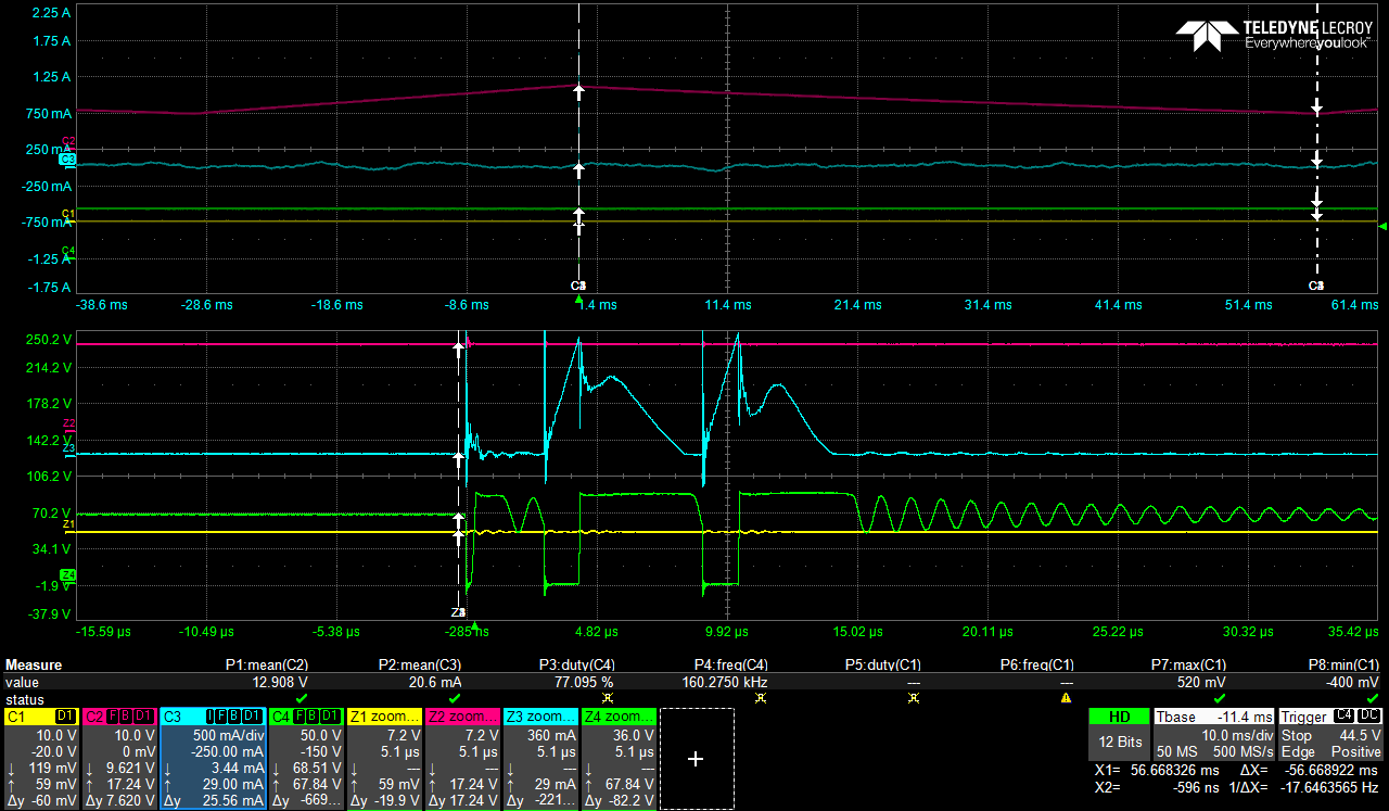

  • Hi Jaden,
    Thanks for your answer. Indeed I don't have the 1.5s hiccup more like something below 100ms. see image below Vdd1 is in pink (CH2). I have added the current in the primary of the transformer on channel 3, just in case. CH4 is still the voltage at switching node. CH1 is not connected
    Here are some results :
    • Without modifications I tryed to increase the input voltage close to Brown in point => no effect
    • Place a 1~2pF capacitor on upper resistor of VS pin divider ( the resistor, RVS1, which connected from AUX winding to VS pin) => no effect
    But doing both gives me 5 pulses (see below) !
    I will try the flying resistor. I have followed the recommendation of the datasheet regarding layout : no ground plane below VS net and short loop between Rvs2 and UCC28780. So I will make a flying wire to connect AUX to Rvs1 (and disconnect partially Rvs1).
    If you have comments regarding the current waveform, I will be happy to read them. Note : I have chosen a "big" Cclamp (on primary side) and a secondary resonance with Co1.
    Thanks again

  • Hi Julien,
    5 PWML pulses means it already close to Brown in voltage , Increase the input voltage you will see controller soft start if there is no other protection.
    Thanks.
