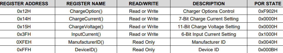

    If the I2C master does not issue BQ24725A address with WRITE bit set and set the register address to read back first,  the master just issues BQ24725A address with READ bit set to preform read operation directly, what 16-bit value will BQ24725A return ?is it 0x01FF?

    Thanks for the info. At POR, the BQ24725A registers should read back the values shown in Table 2 below:

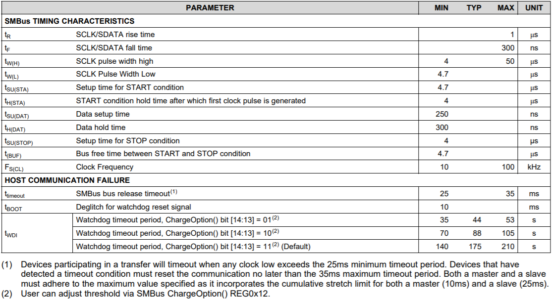

    Since you mentioned that the 40 ms SCL low event only occurs rarely, it's possible that this behavior is noise related. Can you please capture a zoomed-in SMBus communication waveform so we can make sure the rise times and fall times are fast/crisp enough, as shown in the SMBus timing characteristics below?
    I see that the schematic includes a PCA9306 voltage translator, so when you capture waveforms, please probe SCL1/SDA1 instead of SCL2/SDA2. We want to examine the SDA/SCL lines on the BQ24725A side just in case the PCA9306 is affecting the communication signal.

    We measured the important timing parameters at the charger side (2.5V level), all meets the datasheet. There is no signal integrity issue . please see the attached captured waveform.
    If the charger is too busy, will it stretch the SCL signals for longer than 35ms and reset its SCL logic module? We also suspect 0x01FF is a default value for registers other than those listed in the table 2.
    Peng,
    Item
    Requirement
    Measurement
    SCLK/SDATA rise time, Tr
    1us Max
    175/195ns
    SCLK/SDATA fall time, Tf
    300ns Max
    22.25/21.73ns
    SCLK Pulse Duration high, Tw(h)
    4 – 50us
    6.1us Min
    SCLK Pulse Duration Low, Tw(l)
    4.7us Min
    5.06us Min
    Setup time for START condition, Tsu(sta)
    4.7us Min
    5.5us Min
    START condition hold time after which first clock pulse is generated, Th(sta)
    4us Min
    4.99us
    Data setup time, Tsu(dat)
    250ns Min
    3.4us
    Data hold time, Th(dat)
    300ns Min
    755ns
    Setup time for STOP condition, Tsu(stop)
    4us Min
    10.7us
    Bus Free time between START and STOP condition, T(buf)
    4.7us Min
    35us
    Clock Frequency, Fs(cl)
    10 – 100 KHz
    100 KHZ

    The SMBus spec allows slave devices (such as the BQ24725A) to perform clock stretching. This indicates to the host that the slave device is busy, which allows slower slave devices to communicate with faster master devices. However, SCL cannot be held low for too long due to the SMBus release timeout. If SCL is held low for >25 ms, this is interpreted as a timeout condition. Devices that have detected this SMBus release timeout must reset their communication within 10 ms. The 35 ms maximum SMBus release timeout value comes from combining the stretch limit for a slave (25 ms) and a master (10 ms).
    In my testing with the BQ24725A EVM, I have not been able to reproduce the behavior that you describe with the registers PORing with 0x01FF. The registers' POR values match Table 2, as expected.
