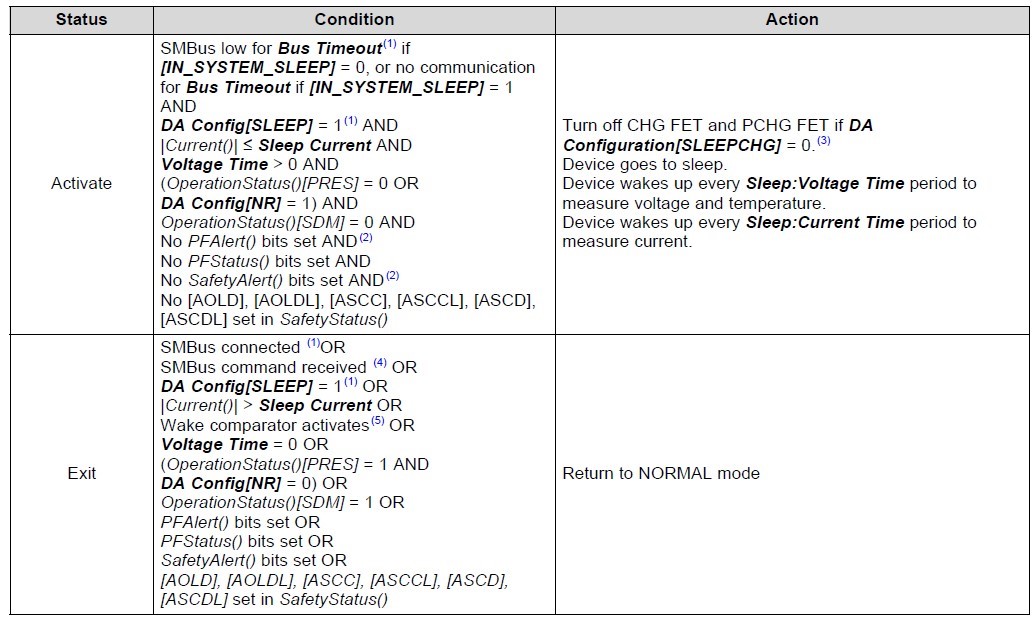

Hello Sir:
I have questions about ZVCHG.
Please refer the question as below.
What flags will update on registers when ZVCHG condition ?
Do you have a lists as below fig?
