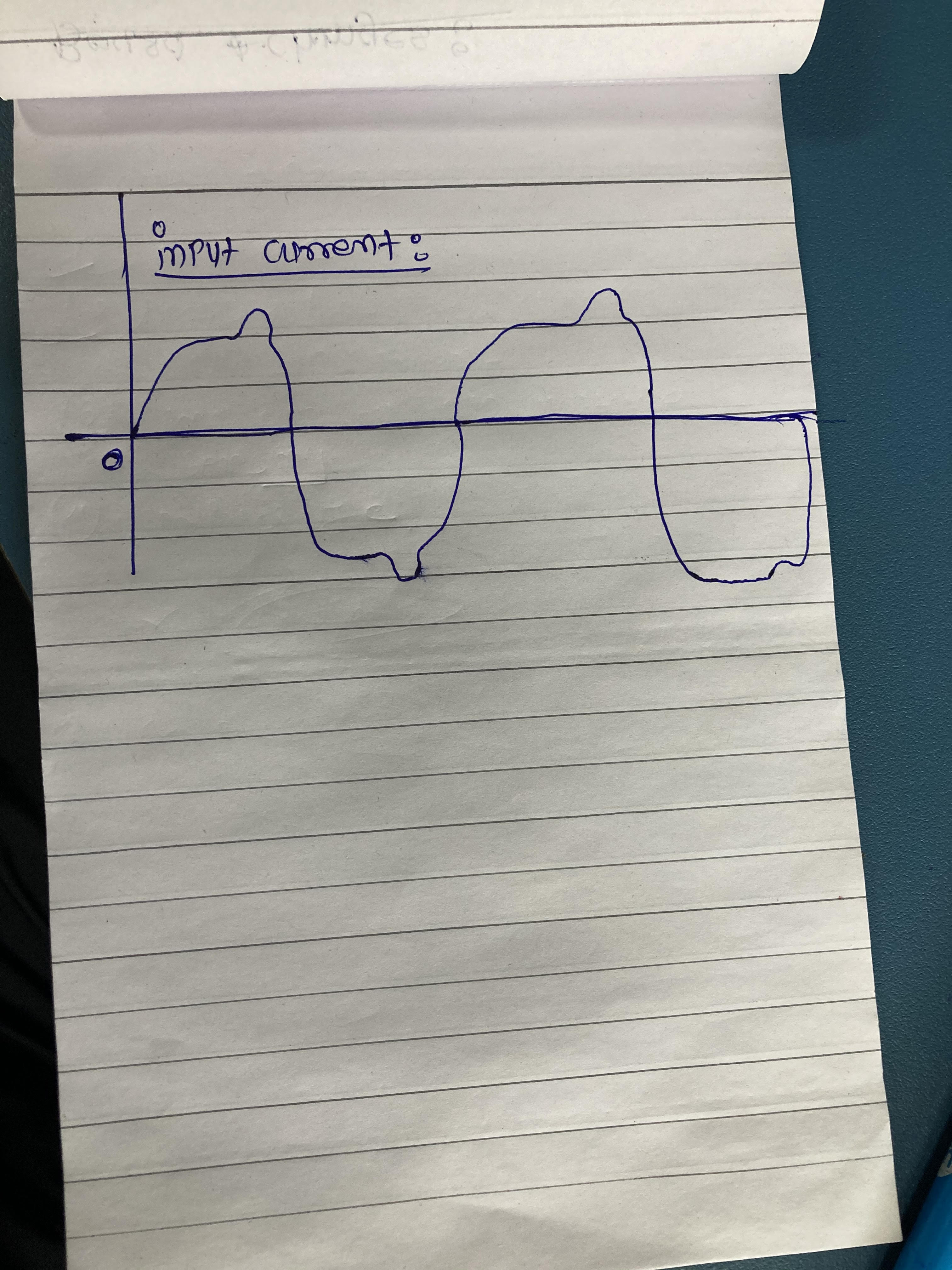

Hello Sir,
I have designed PFC for 960W Output power.
When Output power increase above 900W then input current wave form is distorted.
Please give any suggestion to resolve this issue.
Bharat
Hi, Bharat
Could you offer waveforms on input current and ICOMP pin of UCC28180?
Normally, current shunt of PFC affect the current waveform of input current, you can try decrease current shunt a little bit first.
BR,
Yunsheng
Hi, Bharat
Based on your waveform, I think it is related to the large current shunt, could you decrease current shunt to half value of original value?
Yunsheng
