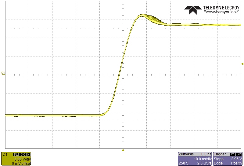

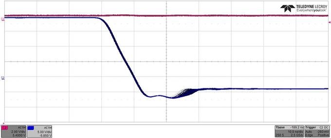

We have an application (H-bridge step-down converter) where an absolute low-noise operation is required. We noticed variations in the output voltage, which we could trace to a Jitter in the phase-leg-output voltage waveform, as shown in the picture below (first division after t=0, recorded with persistency)
This (sometimes) happens, when a negative phase-leg output current commutates from the lower FET to the upper diode, and then after the deadtime to the upper FET.
Note that the slow slope is due to the limited bandwidth (100 MHz) of our differential probe.
This jittering does only happen in a certain range of operation points. Funnily, it disappears if we connect an other differential probe to the PWM input signal of the LMG5200.

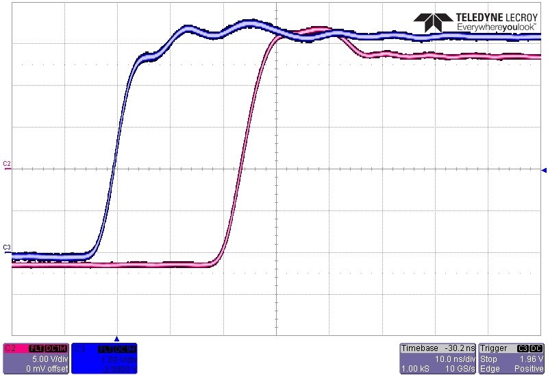

  • Hello Nathan
    You say above: "Therefore, I'd expect to see this if HI transitions 1-2 ns before the SW moves so that the signal hits the level shifter at the same time as SW moves."
    To my understanding, we are far from this situation. I attached a picture to illustrate. Unfortunately, there is no jitter here since that was with a probe connected, but the timing remains pretty much the same.
    Ch2: (red): SW-node potential
    Ch3 (blue): HI input
    We have selected a deadtime of 12 ns. As you can see in the picture, the SW-node starts to rise ca. 25 ns after the PWM input. This is also the case when we observe jittering. So the PWM-command should go through the level shifter with a safe margin before it is blanked due to SW-node transition.
    Any ideas or comments?
    Again for the minimum pulse time: What would happen if the HI input sees a short spike back to 0 during the switch-node transition? And if this somehow leads to a pulse shorter than 10ns?
    We will tomorrow try out whether we can place the C of the PWM RC-filter closer to the IC, to see whether this changes things.
    Beat
  • Hi Beat,
    I set up a sim to see the internal timing, and it looks like I was incorrect in my previous timing estimates. For typical unit at room temp, from the LI/HI input transitioning to the signal hitting the critical part of the level shifter where a SW transition would halt propagation would be about ~12ns, and the critical time window would extend for another ~5 ns after that. Your scope capture does not show this as being the problem, but there is an inconsistency I also see. It looks like the prop delay from HI rising to the high-side on is ~45 ns which seems too long for a unit at room. Is this signal probed directly at HI or before the isolator or R/C filter? Is the unit hot?
    You may try adjusting the dead time and see if that fixes the jitter for that point, that would help to tell you something.
    Nathan

    Yes, we played with deadtime, and it changes in a sense that the jitter happens in other operation points. But we did not completely bring it away. Unfortunately, at the moment we can only change it in 4ns steps.
    For the inconsistency you have pointed out: Yes, your are right. I can't explain why, but the waveform changes within a few 0.1 A steps. Attached are two pictures, one with 2.1 A, one with 2.5 A. While the transition from 3rd quadrant to FET happens about at the expected time at 2.1 A, it gets quite a bit delayed with only 0.4 A more. No idea why this is. I don't see other things changing, it's just that piece of the waveform.
    (Note that this would not bother us too much as long as the waveform remains constant for a given operation point.)
    Maybe this and the jittering are related? Any ideas on your side?
    Regards & thanks
    Beat
  • Hi Beat,
     My guess is that this is driven by the internal level shifter blanking. When you are at the first operating condition in the scope capture above, the signal is getting propagated before the SW rises, but it is right on the edge, a small shift in current and now it has to wait till after the SW rises. This is also what is causing the jitter. The blank is also not completely binary, as you are very close to the edge, it will modulate the propagation time even if it does get through the level shifter.
    As you say, changing the dead time should move the jittering spot to a new operating location where the SW rises in the correct spot.
    Nathan
