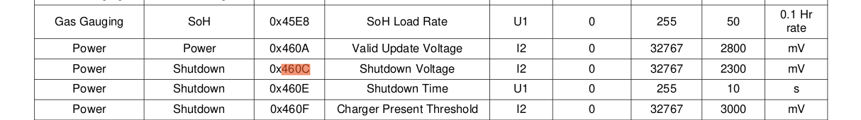

  • Dear Mr. Kang,
    We want to change "Shutdown Voltage" - Class: Power, Subclass: Shutdown
    Current result is: 0C 46 FC 08
    FC 08 is in little endian => Shutdown voltage is 0x08FC = 2300 => It is default value, we want to change it from driver side.

  • Dear Mr. Kang,
    Yes we just write 2 bytes 0C 46 as example, function fg_mac_read_block will read back 36 bytes for checksum and the problem is last 2 bytes are wrong (checksum and length)
