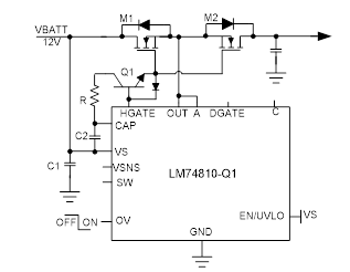

Per application note, LM7480-Q1 gate drive strength can be extended to charge pump capacity(~3mA) with below configuration:
Customer would like to know whether there's other external circuit configuration which could help extend the gate drive current to 100mA.
Or I should suggest them using a charge pump/ boost IC to achieve this?
