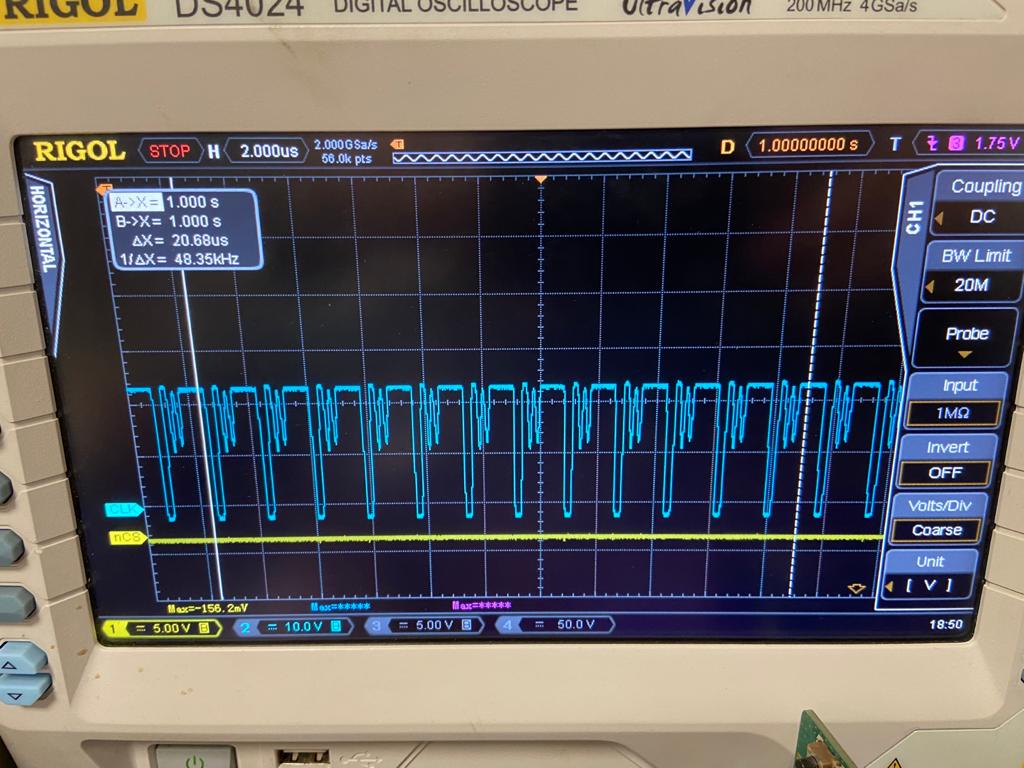

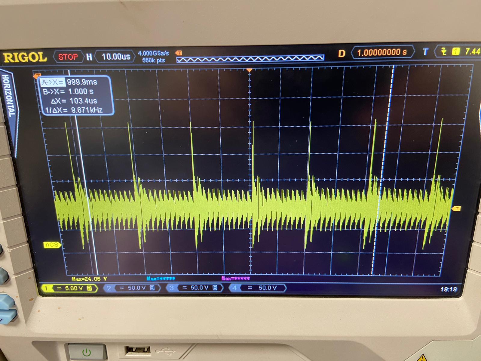

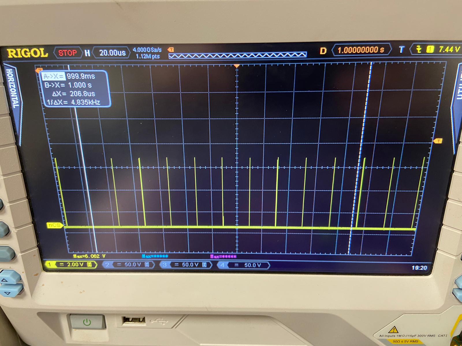

  • Hello again,
    Configuring the BQ24610 to charge with 50 mA current in order to not burn the PCB, I have the following HIDRV signal:
    And the PH signal is the following:
    Finally, the LODRV signal is the following (I think it's ok):
    What is happening with the high side MOSFET? What is wrong in the design?
    Thank you very much.

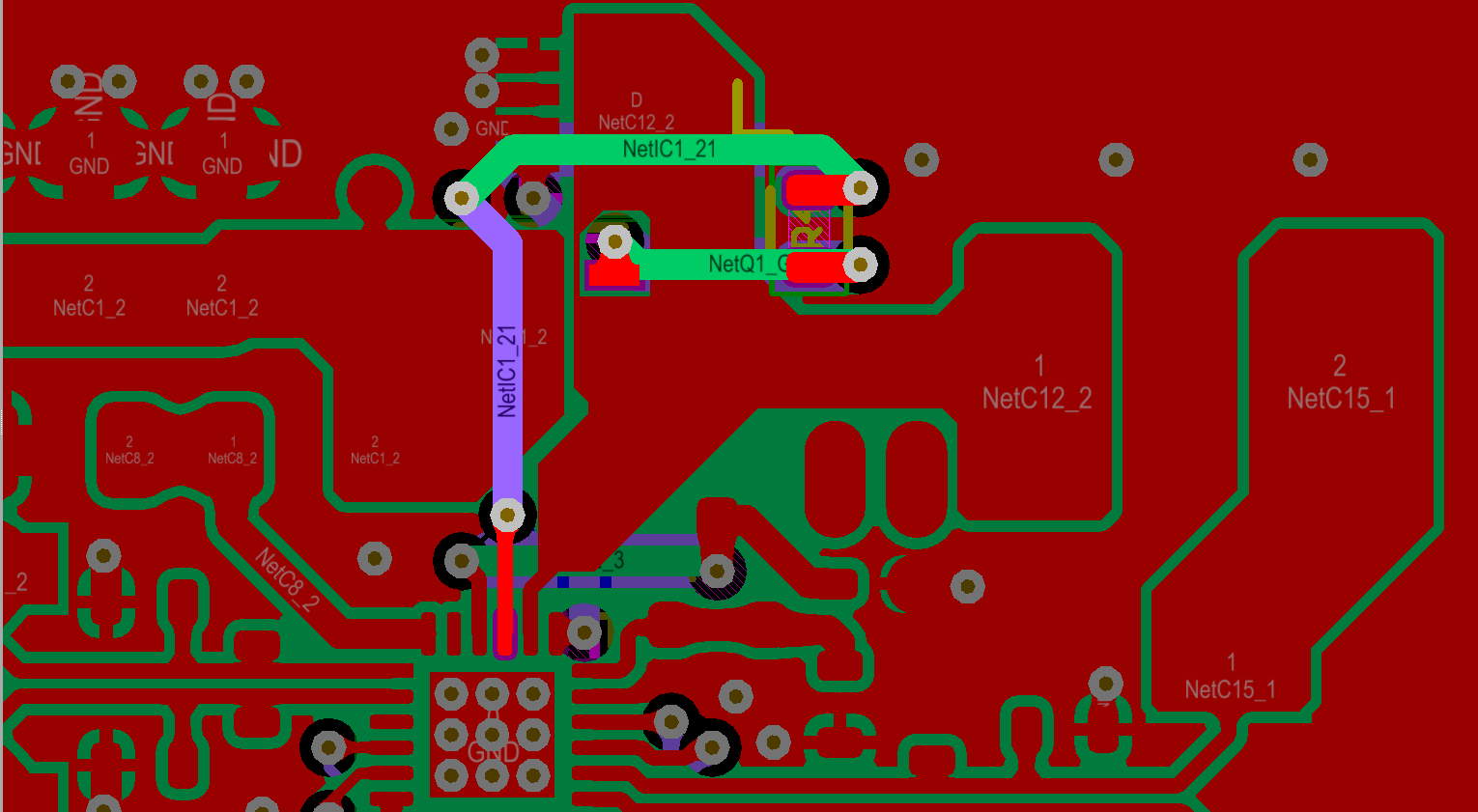

  • Hello Kedar,
    Can I improve this behaviour doing some modification or something? I have a 1KOhm series resistor to the gate of the MOSFET..
    My gate trace is the following:
    Can I solve this in some way? Some idea in order to not perform a redesign by the moment...
    Thank you a lot.

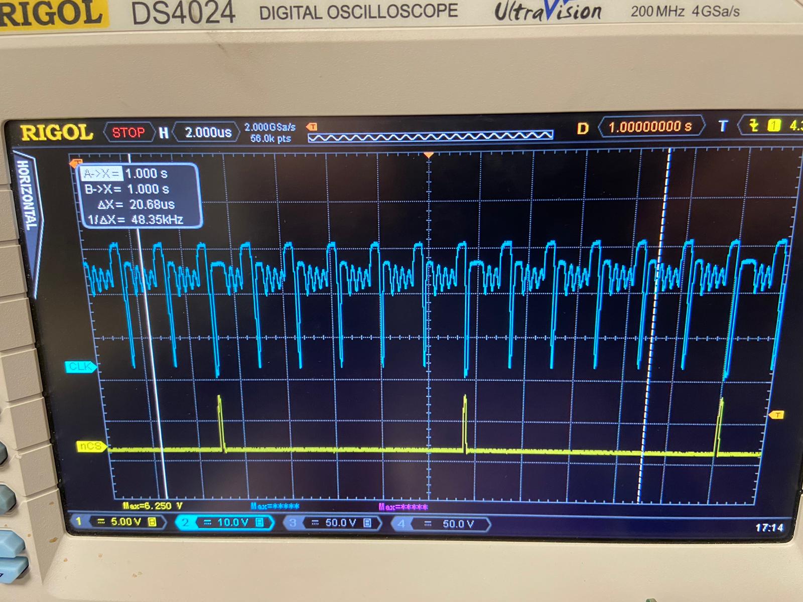

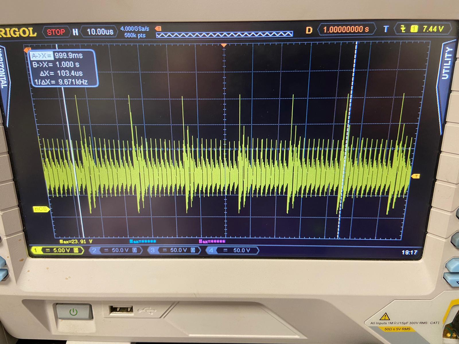

  • Hello again,
    I have changed the high side gate resistor to 50 Ohms.
    High side gate (blue) and low side gate (yellow) can be seen in the following image (battery absent):
    When I connect the battery, we can see PH signal (blue) and LODR (yellow) in the following image:
    Why I have this ringing in the HIDRV signal and the PH signal? The LODRV is OK? The frequencies don't match. When I connect the battery I don't see LODR, is always 0. Is this normal?
    Thank you.
  • Hi Luis,
        The gate drive series resistor increases gate driver loss considerably and will contribute to heat. The downside of adding a series resistor is that it slows both turn on and turn off of he HSFET, and the benefit of reducing EMI is really only when you slow down turn on. I would recommend using a 4.7ohm resistor if you need to include a series HIDRV resistor, and there is no need for any series resistance in the LODRV path.
