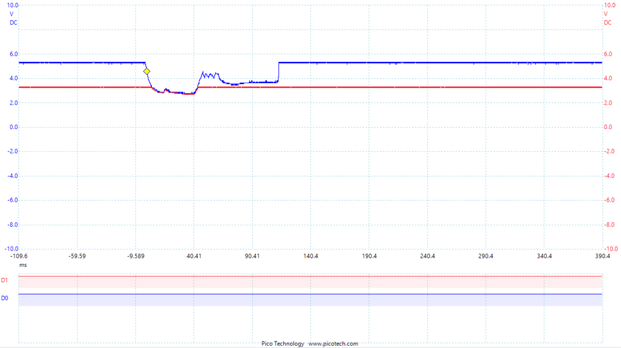

    So after the suggestions I looked a bit on the time criteria. Most of the time, the error occurs after 1 hour of running. This made me a bit suspicious, because every hour the uC is storing data on an external flash. So my next intention was to verify, if the problem occours when I'm storing data, and well I think that's the problem, look at this:
    Analog Blue is measuring the VP pin, red is the RX line (TX of the BQ).
    My guess is, that when storing data, I first need to erase some flash sectors, thus requiring more current. The power of the uC and the Flash comes from a 5V to 3.3V voltage regulator (200mA), who is powered by the VP pin. On the datasheet, the flash can need up to 100mA when erasing data.
    It looks like the voltage drop on VP only has an effect on the BQ, because the flash and the uC are behaving "normal" (no storage failure, no reset of the uC). Could this be the problem, that the BQ gets a POR-like event on the VP pin and thus a software-reset?
    Best regards
    Alain
  • Hi Alain,
    Yes that could cause a digital reset - it looks like you did a good job to diagnose this! And 100mA can be too much for this pin - can you find an alternative way to power the regulator?
    Taylor
  • Hi Taylor,
    thanks for your feedback. At the moment, we don't have an alternative way to power the regulator, but I've ordered a similar flash chip with less current consumption.
    Meanwhile I've run the board without the store function and it seems, that this is indeed the problem. I'll come back after I checked with the alternative flash!
