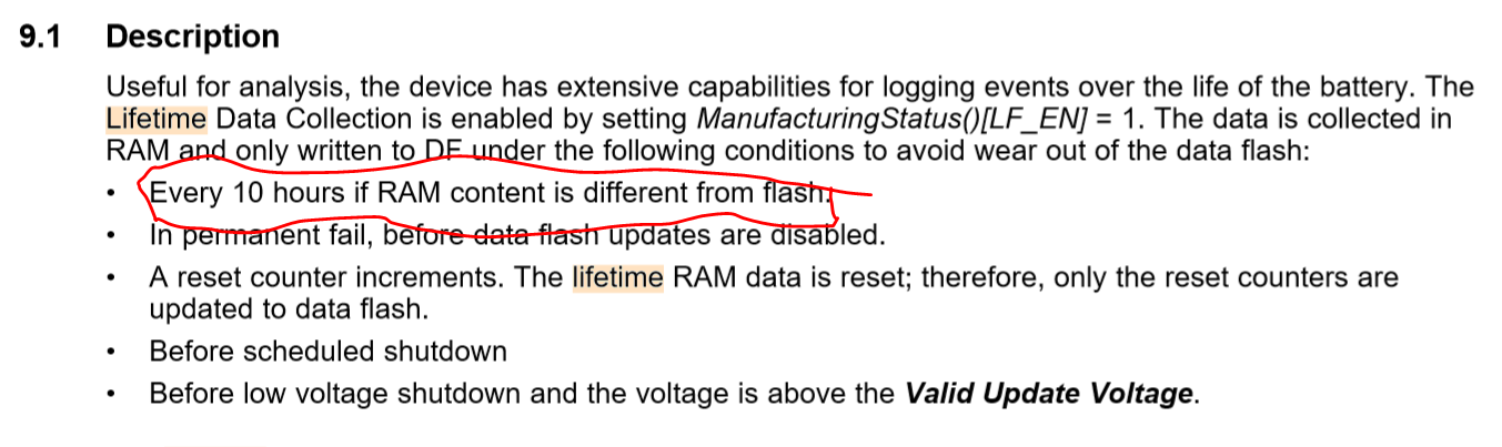

I have a quick question about bq40z50-R1 TRM.
In 9.1 here, does it mean the lifetime DF is updated every 10hours? Isn't it 'real-time'?
Also, is there any filter to filter out accidental sample error of the data collected in RAM? Thanks.

Hello Hollis,
The values read by commands are in the RAM locations, the DataFlash (DF) gets updated with those conditions. If the gauge loses power and the RAM lifetime data was different than the lifetime DF data then when the gauge starts up again the RAM will be updated from the DF so it may change.
There are no filters for writing the lifetime data to DF.
