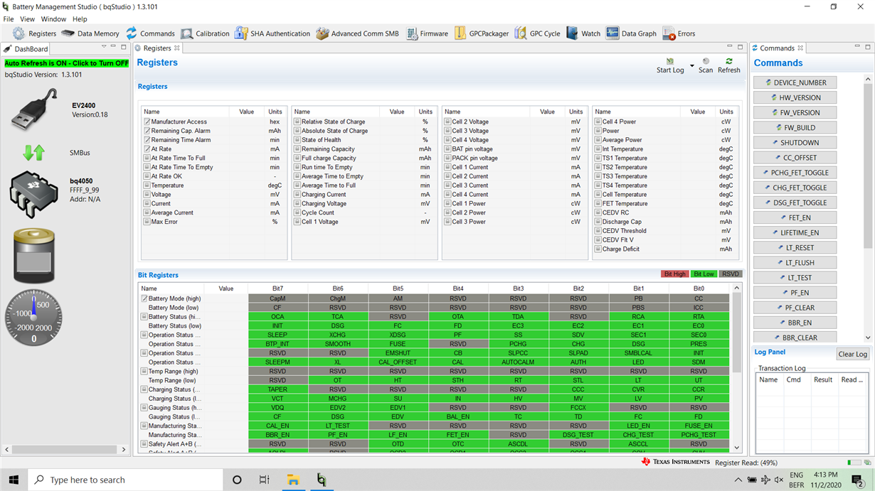

Hello guys,
thanks in advance for your support.
I can read the controller SN but not other registers. UNSEAL has been tried. But it doesn't help.
Hello Yevhen,
It looks like bqStudio is not communicating correctly, make sure the connectors for the EV2400 are in the SMBus section, not I2C.
Also there are more instructions in the EVM start guide: www.ti.com/.../sluubf9.pdf

Hello Yevhen,
Make sure you run bqStudio as admin and the EV2400 firmware is updated. Also try using the stable version of bqStudio instead of the test version.

Hello Yevhen,
I have seen this error from plugging a SMBUS device into the !2C port of the EV2400, I would double check the communication line connections and install the latest EV2400 firmware.
Do you get this kind of issue with any other boards?
Sincerely,
Wyatt Keller
Thank you for your reply.
My colleague has checked SMBus lines already. No problem with them.
Tomorrow he will try one more time with another board.
